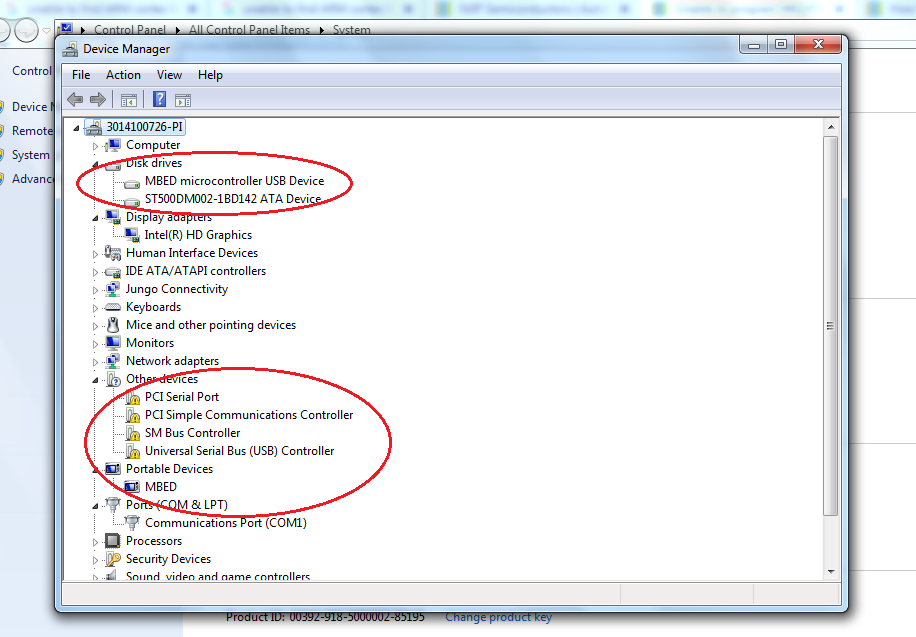

gauravmore
Hi Jeremy,
Thanks for your reply,
I will follow the instructions suggested by you. Out of that, 1st 2 points we have already modified at our side . Will check after modifying the 3rd point.
Regarding the FRDM board I am facing issue of Driver installation after connecting the FRDM board it starts the installation but it is unable to install some drivers.
Screenshot attached.
But I have evaluation board of LPC11U68 and PE MIcro FX Rev D. Can i use LPC11u68 Evaluation board? I tried to programm the FRDM eval board using LPC11U68 since i was facing the issue with the drivers installation.
Is it necessary to use Jlink only for this controller? I do not have rigth now and will take time to get after ordered.
Please confirm the above reagrding the usage of the debugger i mentioned apart from JLink.

kerryzhou
Hi Gaurav More,
  What's the windows system you are using?
  If you are using win10 with FRDM-K22, please refer to this link:
OpenSDA Serial and Debug Adapter | NXP
   You need to update the on board K20 debugger firmware at first.
   If you are using win7, it should don't have problems.
   Do you try the JLINK firmware for FRDM-K22 ?

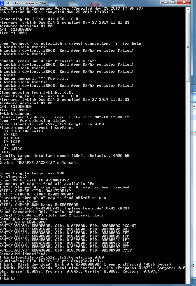

gauravmore
Hi Kerry,
Sorry I used name Jeremy :smileyhappy: Instead. Thanks for the reply.
I tried all the procedures mentioned by you and able to successfully programm the development board.

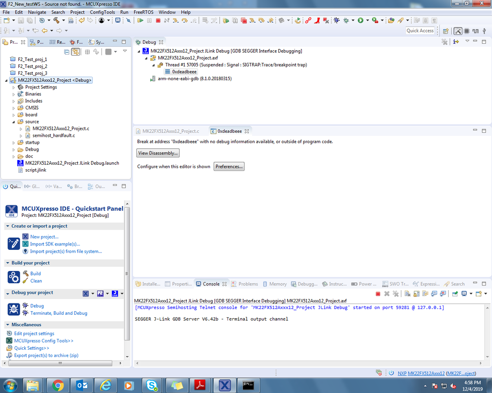

After trying the procedures I am able to programm the code but now when i teied it multiple times then it gives me the error mentioned below.
When i tried to mass erase the controller and when I connect the board through SWD with J link the  FRDMK22F board's small red LED (D2) is turned on.

What would be the reason for the same. since the code is the same with LED Toggling only.
This issue is similar with the issue mentioned in  below link
https://community.nxp.com/thread/378870
But here i am using FRDM_K22F board for programming and debugging my development board,
Please check for the same and let us know . It seems like the controller is in reset wihile Jlink is trying to connect. So no core is found.
Need to know the exact procedure for removing the controller form unlock mode other wise once it is unlocked the we programmed then againg it behaves the same way. This is waht is observed in most of the forums related to FRRDM K22F.
Awaiting reply.

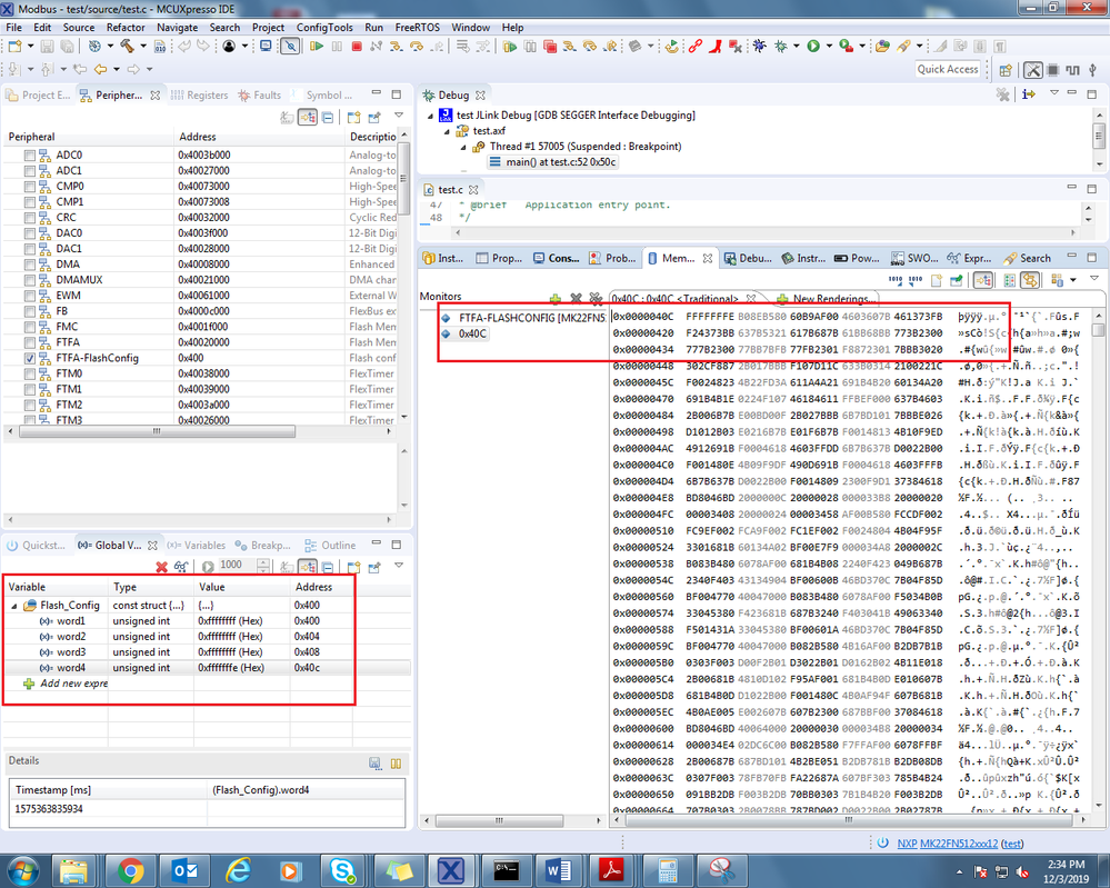

  BTW, check your firmware, whether you lock the code in the firmware, 0X40C, check it,
Do you lock it in the code?
 Now, if you use the FRDM-K22 with the on board K22 chip, you also enter the lock problems? You can download the official SDK code for FRDM-K22 , whether it still have problems?

gauravmore
Hi Kerry,
Yes I refered the document and followed the procedure.
Yes I was able to program and debug the othere FRDMK22 board and yes the project created is using the SDK and I am not facing any issue.  Now I will check with the Official SDK code and alos is upgraded the OpenSDA Ver 2.1 as per the link provided by you  in the above reply.
Regarding the Lock in the firmware that need to check but,  How to check or compare whether the lock is enable in the SDK and My firmware?
Gaurav More
11,101 Views
kerryzhou
Hi Gaurav More,

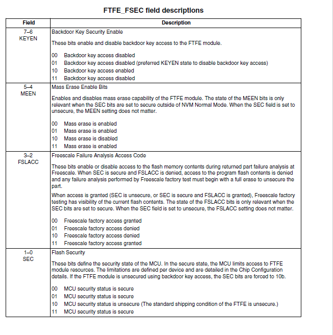

  If you are using the SDK in default, the code didn't lock the secure byte.
  Abou your own firmware, you can generate the .hex file, then check flash address 0X40C data, and compare with the the FSEC register which I post you in the last reply.
Kerry
11,101 Views

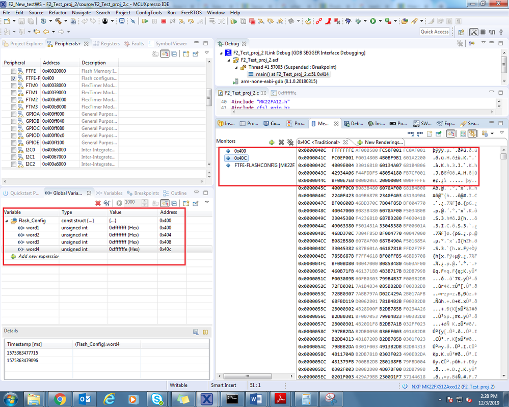

gauravmore
Hi Kerry,
I check the flash settings in 0x40C in the project that we created.
The values of the  FSEC registor in the SDK  based project.
You can see both are same but when we project the development board after once we program then we are not able to connect . But same thing when we did with the FRDM K22F board then there its working fine for multiple times . please find attached project for bothe the controllers for your reference i order to find the difference between the code w.r.t to JLink or Jtag access
CC:[email protected]‌

Device "MK22FX512AXXX12" selected.
Connecting to target via SWD
InitTarget()
Connect Under Reset
Communication error while accessing MDM-AP.
Connect Under Reset
InitTarget()
Connect Under Reset
Connect Under Reset
****** Error: InitTarget(): PCode returned with error code -1
InitTarget()
Connect Under Reset
Connect Under Reset
InitTarget()
Connect Under Reset
Connect Under Reset
Cannot connect to target.
Script processing completed.
Unable to perform operation!
Command failed with exit code 1
As result agian we faced the same issue with your project as well. Do we have any SDK similar to FRDMK22F board? or any evaluation board of K22FX series?
Similar behaviour  is observed with your project as well.
Let me know what to do for this, Is there thing w are missing in the hardware which is required,or also you can check with the people who have used this controller MK22FX512AVLQ12 .

  When you use my project, if you set a breakpoint in the main, can you enter the main?
  Or you totally can't make the project works?
  About the official board, we don't have the MK22FX512AVLQ12 board, the similar board is TWR-K21F120M board, but it also can't fun the MK22FX512AVLQ12 code.
  I attach a bin file, the code function is toggle PTC18, it is your LED1.
  You can use the JLINK commander to download the .bin file to your board directly, copy MK22FX512AVLQ12 _TEST.bin to your JLINK install path, the JLINK commander is:
 loadfile MK22FX512AVLQ12 _TEST.bin 0x00
  Please try it on your side, after download the code, you can power off and power on the board again, check your PTC18, whether it is working or not?
  I use KDS IDE generate the code, no SDK.
Any updated test result, please kindly let me know.
Kerry

gauravmore
Hi Kerry,
Thanks for the reply,
Yes we were able to programm the using your project and was able to run and stop in main but only for the first time. But after terminate and relaunching the same code, it was entering the main , instead it was going to some address
then we tried to stop and reset te code but still it was not running in main. Now regarding the bin file you sent, did'nt get the purpose of this since if it runs then  what will we conclude?
Still i will check and let you know immediately.
Gaurav More.
