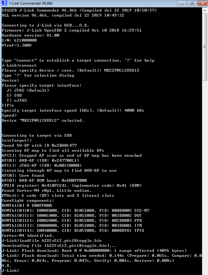

Hi Gaurav More,
   It's good to hear that my new .bin code works on your side.
   Now, it seems your problem still be caused by the hardware instability!
   Please do these following things checking:
1. After you download the gpio toggle firmware, then use the JLINK to connect your board again, you will find it can't connect, please use the oscilloscope to check reset pin wave, then send it to me!
2. Do you solder any other board with the same schematic? Still the same problem?
   Don't just test one board, try more boards, whether have the same problem?

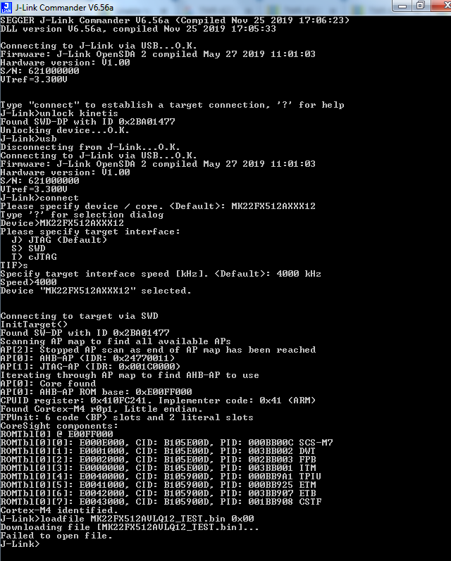

We will  check and update you soon. But  there is one query regarding the controller we ae using.  We have selected MK22FX512AVLQ12 but we also have MK22FX512AVL12 . What is the difference in these controllers?
We tried with MK22FX512VLQ12 as well .
For MK22FX512VLQ12 NXP says not recommended for furture design. What if used the code of MK22FX512AVLQ12 and programmed in MK22FX512VLQ12 controller?

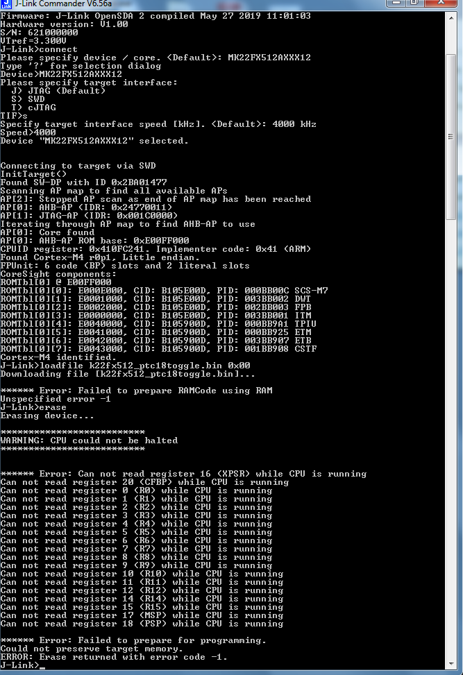

Also reagrding the firmware you sent we downloaded it and checked it is working but the we tried to reconnect the board to debug our firmware, but we are not able to connected. Then we tried to erase using erase_all_pins.jlk command and then tried to downliad you code again then we re getting this error
then onwards we tried to erase but now it is not erasing instead it is giving this error
We are trying to eraase but still nort able erase.  Not able to find the reason for the same.

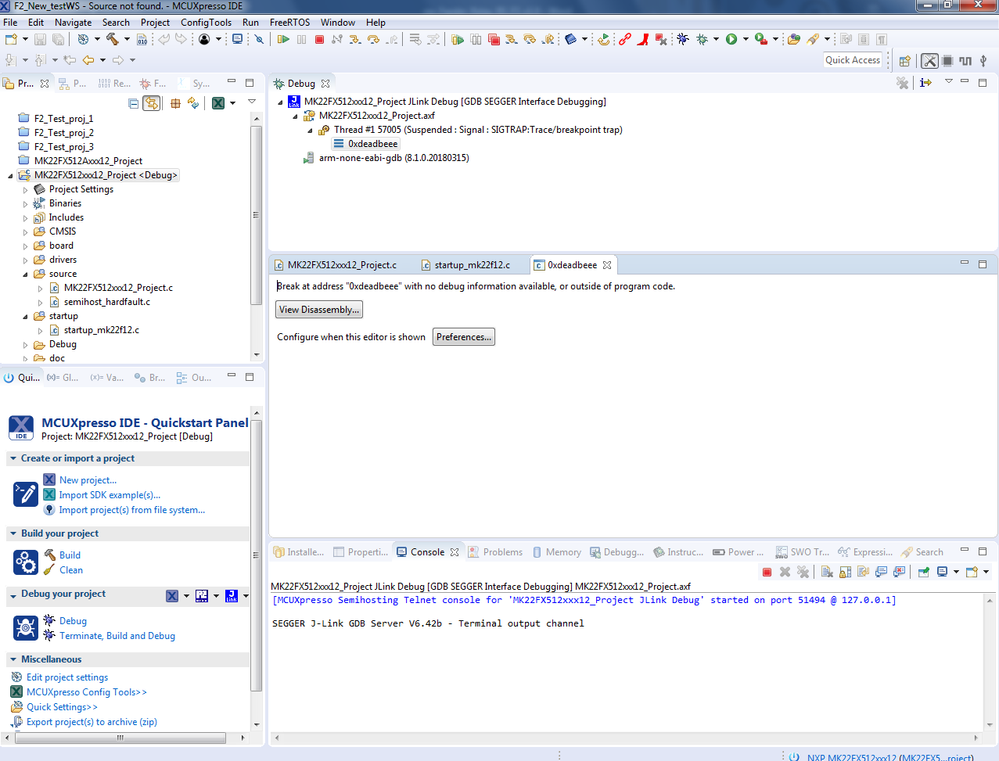

One mistake from our side , we were trying to program MK22FX512VLQ12  using MK22FX512AVLQ12  Project.
So we made the modification and created a new project for MK22FX512VLQ12 and made the modification suggested by [email protected] .
As a result we were able to program the code multiple times. But in between we are facing certain issues like
1. while trying for multiple times debugg by terminating and relaunching in gives follwing error
ERROR: Could not connect to target.

2. After that we erase the flash using MCU Xpresso GUI flash erase tool. And again we tried to program and debug, Then it gives following error,
3. When we click on yes the it gives the same error again and then we click yes and then it goes into the following loop.
4. After that we terminate it and agian tried to launch and debug. then it again gives the error mentioned in 1st point. after that we shut down the power and also disconnect the Jlink from PC and again powerup both and then tried to program then it got programmed.
Only diffeence we observed is that it is erassing the flash using MCUXpresso GUI tool. and it is not required any Jlink commander til now,
What is the reason for the same? This behaviour is also not sure need the same sequence which we followed mentioned in 4 the point. Some times it is not allowing to erase the controller and it shows Point no 2 error. and gives the error "ERROR: DAP error while reading DP-Ctrl-Stat register."

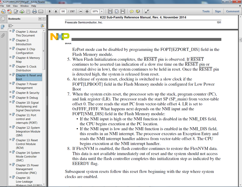

One observation regarding the code. When we program the controller with GPIO Toggling code then while debugging it is observed that this goes to NMI Handler
and when we checked the voltage at PTA4 Which is 3.3V pulled up with 10K resistor it is showing 1.2 to 1.6 Volt.
As per the data sheet  controller will go to NMI handler if there is interrupt in the pin.
Is it the case that due to this pin it is not allowing Jlink to debug the controller?  We also tried by disabling the pin in the code but still it hangs and when checked it shows that it is in NMI handler
Gaurav More
20,545 Views
kerryzhou
Hi Gaurav More,
  Thanks for your updated information.     Please change your NMI pull up resistor to 4.7k instead of 10K, it seems your 10K still not enough.
   Please try it on your side.
   Any updated information, just let me know.
Kerry

2. MAss Erase
4. Unlock kinetis
5.  usb
6. connect and    After connect, then use the loadfile command to download the code.
See the log below.
No I donot have the external Seger Jlink that why  I made it using K22FRDM board as per your procedure. But that Jlink is workig fine with FRDM board Programming and Debugging, So i think there is no issue with the Jlink created,
Can you create the Jlink at your side instead of using the seperate Jlink and programm the other FRDM board as we are doing.  See I want to confirm the Jtag to be used then only  I can order. Since PE Mocro and CMSIS-DAP is not working so only Jlink need to tested, but as per the  forum of PEMicro http://www.pemicro.com/forums/forum.cfm?forum_topic_id=6460
These people are able to program the controller. We ahev PE Micro (Rev B / D) and CMSIS-DAP debugger.
Gaurav More

 I can't see your log.
 About the FRDM connect to another FRDM, I have test it in the previous time, it works.
  If you have the PR micro, you also can use the SWD pin to connect your own board, and debug it.
  But I suggest you use the JLINK do the mass erase at first.
  About the connection, you can check your P&E Mulitilink, just make sure these pins are connect correctly:
 VCC, GND, SWD_DIO, SWD_clk, reset_B.
Kerry

kerryzhou
Hi Gaurav More,
    I just test the .bin code which I give you before, I find that KDS generated .bin have problems, that's why you can't download it.
    So, I modify the SDK for K22FX chip with IAR IDE, I write the PTD18 toggle code again.
    Please help to test it, I attached the new firmware for you.
     Because I don't have your K22 board, so I just test the .bin in FRDM-K22, check whether I can download or not, this is my result:
Please use my new firmware, and use JLINK download it to your own board again.
Any updated information, please let me know.
If you don't have the external JLINK, you don't need to buy it, because your Multilink also have problem, I think it may also related to the hardware stable problem.
You can use the FRDM-K22 on board JLINK test it at first.
kerry
