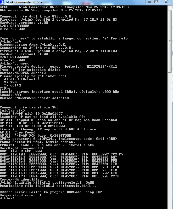

Hi ,
I am using MK22FX512AVLQ12 controller in one of my product. I have made the development board for the same. But after assembly I am not able to programm the controller. i am using PE MICRO FX debugger. Before going for the development board design I first evaluated  FREEDOM K22F evaluation board.
I used MCU Xpresso for the evaluation and PE MICRO (Rev B, D, FX Rev D) All these wer able to programme. Also i used LPC11U68 Eval board Debugger for programming . I was able to programm and debug using all these debuger.
But now when i made the development board of MK22FX512AVLQ12 controller and tried to programme then it is showing error.
I have attached the schematic and also made the modification in the hardware like pull up to EZ_CS pin as per the input from one of the forum.
I am facing this issue from last 3-4 days but still no sucess, please check the schematic and suggest the solution for the same.

Hi Gaurav More,
   It's good to hear that my new .bin code works on your side.
   Now, it seems your problem still be caused by the hardware instability!
   Please do these following things checking:
1. After you download the gpio toggle firmware, then use the JLINK to connect your board again, you will find it can't connect, please use the oscilloscope to check reset pin wave, then send it to me!
2. Do you solder any other board with the same schematic? Still the same problem?
   Don't just test one board, try more boards, whether have the same problem?
3. When you sold the board, please note the temperature can't exceed 260 degree.
4. When you connect the JLINK, please note the power on and power off sequence.
   Power on: connect Debugger, power on the target board
   Power off: Power off the target board, disconnect debugger
  Just don't do the hot plug
5. Please check your power
   Whether it is stable or not? You can also try to use the FRDM-K22 on board VDD to power on your target board.
6. You can add refer to Marceli Firlej, add 1nf capacitor to SWD_CLK pin, just make sure your debugger signal is stable and no glitch.
7. debugger wire should be smaller than 15cm.
Please check the above points.
Any updated information, just kindly let me know.

gauravmore
Hi Kerry,
Thanks for the reply,
One mistake from our side , we were trying to program MK22FX512VLQ12  using MK22FX512AVLQ12  Project.
So we made the modification and created a new project for MK22FX512VLQ12 and made the modification suggested by [email protected] .
As a result we were able to program the code multiple times. But in between we are facing certain issues like
1. while trying for multiple times debugg by terminating and relaunching in gives follwing error
ERROR: Could not connect to target.
  SEGGER J-Link GDB Server V6.42b Command Line Version
  JLinkARM.dll V6.42b (DLL compiled Feb  5 2019 17:31:40)
  Command line: -nosilent -swoport 2337 -select USB=123456 -telnetport 2338 -singlerun -endian little -noir -speed auto -port 2339 -vd -device MK22FX512xxx12 -if SWD -halt -reportuseraction
  -----GDB Server start settings-----
  GDBInit file:                  none
  GDB Server Listening port:     2339
  SWO raw output listening port: 2337
  Terminal I/O port:             2338
  Accept remote connection:      localhost only
  Generate logfile:              off
  Verify download:               on
  Init regs on start:            off
  Silent mode:                   off
  Single run mode:               on
  Target connection timeout:     0 ms
  ------J-Link related settings------
  J-Link Host interface:         USB
  J-Link script:                 none
  J-Link settings file:          none
  ------Target related settings------
  Target device:                 MK22FX512xxx12
  Target interface:              SWD
  Target interface speed:        auto
  Target endian:                 little
  Connecting to J-Link...
  $$UserActionStart$$: Terms of use
  $$UserActionEnd$$: Terms of use
  J-Link is connected.
  Device "MK22FX512XXX12" selected.
  Firmware: J-Link OpenSDA 2 compiled May 27 2019 11:01:03
  Hardware: V1.00
  S/N: 621000000
  Checking target voltage...
  Target voltage: 3.30 V
  Listening on TCP/IP port 2339
  Connecting to target...InitTarget()
  Connect Under Reset
  Device will be unsecured now.
  Found SW-DP with ID 0x2BA01477
  InitTarget()
  Connect Under Reset
  ERROR: DAP error while reading DP-Ctrl-Stat register.
2. After that we erase the flash using MCU Xpresso GUI flash erase tool. And again we tried to program and debug, Then it gives following error,
3. When we click on yes the it gives the same error again and then we click yes and then it goes into the following loop.
4. After that we terminate it and agian tried to launch and debug. then it again gives the error mentioned in 1st point. after that we shut down the power and also disconnect the Jlink from PC and again powerup both and then tried to program then it got programmed.
Only diffeence we observed is that it is erassing the flash using MCUXpresso GUI tool. and it is not required any Jlink commander til now,
What is the reason for the same? This behaviour is also not sure need the same sequence which we followed mentioned in 4 the point. Some times it is not allowing to erase the controller and it shows Point no 2 error. and gives the error "ERROR: DAP error while reading DP-Ctrl-Stat register."

gauravmore
Hi Kerry,
One observation regarding the code. When we program the controller with GPIO Toggling code then while debugging it is observed that this goes to NMI Handler
and when we checked the voltage at PTA4 Which is 3.3V pulled up with 10K resistor it is showing 1.2 to 1.6 Volt.
As per the data sheet  controller will go to NMI handler if there is interrupt in the pin.
Is it the case that due to this pin it is not allowing Jlink to debug the controller?  We also tried by disabling the pin in the code but still it hangs and when checked it shows that it is in NMI handler
Gaurav More
18,235件の閲覧回数
kerryzhou
Hi Gaurav More
  Thanks for your updated information.     Please change your NMI pull up resistor to 4.7k instead of 10K, it seems your 10K still not enough.
   Please try it on your side.
   Any updated information, just let me know.
Kerry
18,235件の閲覧回数
gauravmore
Hi Kerry,
Thanks for the reply.
I made the change suggested by you and it worked. I also tested it on other boards as well after making following modifications.
1. NMI Pin  with 4.7K Pull up
2. Added the circuit to Vout33 Pin as  you mentioned
3. SWDIO pin  with 10K pullup
4. SWDCLK  with 1nF capacitor
After making all these changes I am able to program the controller multiple times without any error. I have attached the schematic which is modified . Kindly review the same and revert.

6. connect and    After connect, then use the loadfile command to download the code.
See the log below.
No I donot have the external Seger Jlink that why  I made it using K22FRDM board as per your procedure. But that Jlink is workig fine with FRDM board Programming and Debugging, So i think there is no issue with the Jlink created,
Can you create the Jlink at your side instead of using the seperate Jlink and programm the other FRDM board as we are doing.  See I want to confirm the Jtag to be used then only  I can order. Since PE Mocro and CMSIS-DAP is not working so only Jlink need to tested, but as per the  forum of PEMicro http://www.pemicro.com/forums/forum.cfm?forum_topic_id=6460
These people are able to program the controller. We ahev PE Micro (Rev B / D) and CMSIS-DAP debugger.
Gaurav More

Hi Gaurav More
 I can't see your log.
 About the FRDM connect to another FRDM, I have test it in the previous time, it works.
  If you have the PR micro, you also can use the SWD pin to connect your own board, and debug it.
  But I suggest you use the JLINK do the mass erase at first.
  About the connection, you can check your P&E Mulitilink, just make sure these pins are connect correctly:
 VCC, GND, SWD_DIO, SWD_clk, reset_B.
Kerry

Hi Gaurav More,
    I just test the .bin code which I give you before, I find that KDS generated .bin have problems, that's why you can't download it.
    So, I modify the SDK for K22FX chip with IAR IDE, I write the PTD18 toggle code again.
    Please help to test it, I attached the new firmware for you.
     Because I don't have your K22 board, so I just test the .bin in FRDM-K22, check whether I can download or not, this is my result:
Please use my new firmware, and use JLINK download it to your own board again.
Any updated information, please let me know.
If you don't have the external JLINK, you don't need to buy it, because your Multilink also have problem, I think it may also related to the hardware stable problem.
You can use the FRDM-K22 on board JLINK test it at first.
kerry
