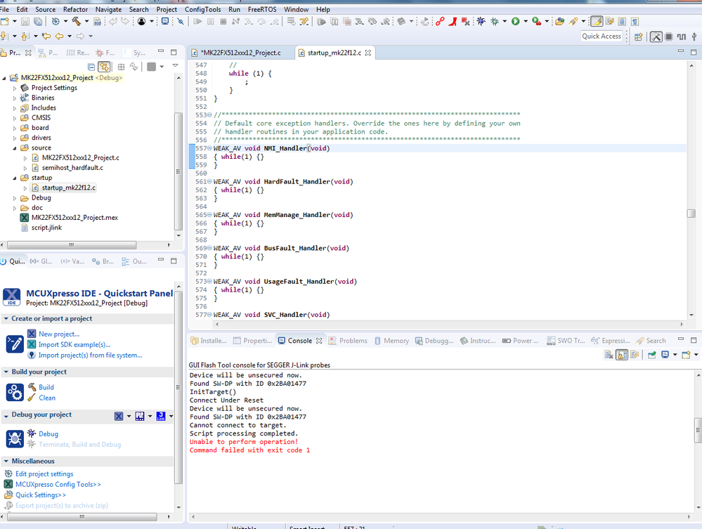

One observation regarding the code. When we program the controller with GPIO Toggling code then while debugging it is observed that this goes to NMI Handler
and when we checked the voltage at PTA4 Which is 3.3V pulled up with 10K resistor it is showing 1.2 to 1.6 Volt.
As per the data sheet  controller will go to NMI handler if there is interrupt in the pin.
Is it the case that due to this pin it is not allowing Jlink to debug the controller?  We also tried by disabling the pin in the code but still it hangs and when checked it shows that it is in NMI handler

kerryzhou
Hi Gaurav More
  Thanks for your updated information.     Please change your NMI pull up resistor to 4.7k instead of 10K, it seems your 10K still not enough.
   Please try it on your side.

gauravmore
Hi Kerry,
Thanks for the reply.
I made the change suggested by you and it worked. I also tested it on other boards as well after making following modifications.
1. NMI Pin  with 4.7K Pull up
2. Added the circuit to Vout33 Pin as  you mentioned
3. SWDIO pin  with 10K pullup
4. SWDCLK  with 1nF capacitor
After making all these changes I am able to program the controller multiple times without any error. I have attached the schematic which is modified . Kindly review the same and revert.
There is one query reagarding this issue. Can you send me the document which mention all these changes documented in data sheet or application note or an Erata. Since we were not able to find this information while referring the datasheet and reference manual of the controller.  Since it has taken a long time to find out the issue and resolve.

2. MAss Erase
4. Unlock kinetis
5.  usb
6. connect and    After connect, then use the loadfile command to download the code.
See the log below.
No I donot have the external Seger Jlink that why  I made it using K22FRDM board as per your procedure. But that Jlink is workig fine with FRDM board Programming and Debugging, So i think there is no issue with the Jlink created,
Can you create the Jlink at your side instead of using the seperate Jlink and programm the other FRDM board as we are doing.  See I want to confirm the Jtag to be used then only  I can order. Since PE Mocro and CMSIS-DAP is not working so only Jlink need to tested, but as per the  forum of PEMicro http://www.pemicro.com/forums/forum.cfm?forum_topic_id=6460
These people are able to program the controller. We ahev PE Micro (Rev B / D) and CMSIS-DAP debugger.

 I can't see your log.
 About the FRDM connect to another FRDM, I have test it in the previous time, it works.
  If you have the PR micro, you also can use the SWD pin to connect your own board, and debug it.
  But I suggest you use the JLINK do the mass erase at first.
  About the connection, you can check your P&E Mulitilink, just make sure these pins are connect correctly:
 VCC, GND, SWD_DIO, SWD_clk, reset_B.
