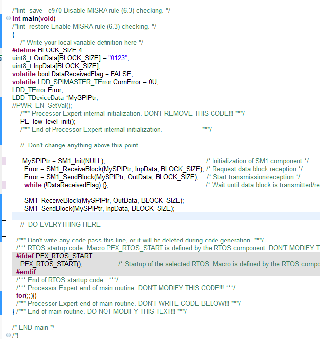

Hi All,
I was testing my SPI connection from my Master (MK22FN256) to my Flash chip (Memory Flash 4Mb(512k x 8) 85MHz ).
I have a lot of other code involved doing other things but I thought I would test my SPI code in my Main.c file (see below).
I checked my CS signal and should be asserted on Low, and was monitoring the CLK signal to determine if it start, and it didn't.  Can some advise me what I'm missing here.  My instincts are telling me I don't have a hex value to with an address available and also a hex value that I would like to send to Flash.
Can someone help?
Brian
1,607 Views
Hello brian cavanagh,
Have you used interrupt service ? If yes,  have you enable the SPI RX interrupt ?
Anyway, there is a DOC instroduce the typical usage of SPI_Master , please find it
at the below link :
PE Generate code SPI SM1_ReceiveBlock not work
Hope it helps
TIC
