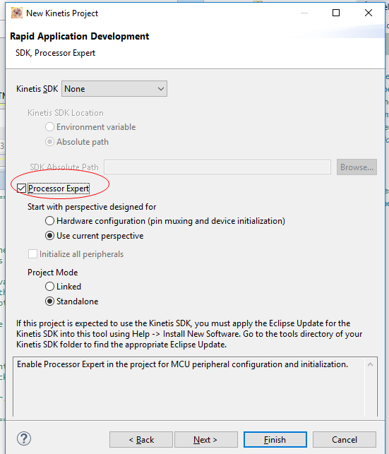

Hey guys,
What is the right IDE for the KL04 series? Its not supported in the MCUXpresso IDE and neither in KDS SDK. Where do I find the libraries and drivers at least? Or has NXP pulled the plug on older Kinetis devices to focus exclusively on LPC? Any help appreciated thank you.
1,673 Views
Hello Pratiek Bhadranavar ,
Recommend  you use KDS, there is the Processor Expert driver :
About the kinetis products support for KDS or MCUXPresso , please refer to this table:
MCUXpresso Supported Devices Table
Hope it helps
