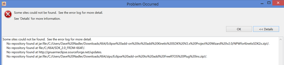

Mark, I tried to run the KDS update, but I got the error message below.
What's going on?
Thanks, Best Regards, Dave
13,303 Views
MarekTrmac
Hi Dave,
the configured sites used for update can be displayed using: main menu - Windows - Preferences - Install/Update - Available Software Sites.
In the list check, that all selected URLs are valid (especially URL referencing JAR file on local machine).
Marek

Marek - Can you please explain how to either:
  1. configure FDS so that it obtains the latest Project Wizard and other tools from NXP's site? I don't know why the 'local JAR' is giving error messages, but in any case it is unhelpful to update from a local JAR (which has not been updated). Alternatively,
  2. where can I download ONLY the latest JAR for Project Wizard and other tools? I certainly do not want to rebuild a new SDK2.0, especially given NXP's horrible example program setup has forced me to work on samples within that directory tree.
Updates should work without ANY intervention in URLs by user!!! This is all rather crazy!

MarekTrmac
Hi Dave,
In Eclipse, command "Check for Update" search all update sites configured in the preferences listed above. By default, there is no JAR preconfigured in KDS 3.2, but it can be added by the user.
NPW can be updated from KDS update site (which is preconfigured in KDS) using "Check for Update" command. This is recommended way and typicaly does not require too much user interaction.
