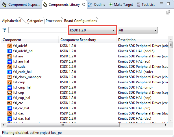

lingqian
Hi Jun,
Thanks for your quick reply and the video, now I can find the TWR-K24F120M board. However, I have to rely on KSDK in order to configure this board. Since I didn't use KSDK before, I am really confusing about how to migrate my previous program to this new one.  For example, perviously, I used SPIMaster_LDD component to set up my SPI transmission function, but there is only a component in KSDK called fsl_dspi. Are they the same? Can I use the same configuration I did before to this component?
Thanks again.
Ling
2,187 Views
ZhangJennie
hi Ling
Processor expert use another set of pe component, starting with fsl_xxx and Init_xxx.
SPIMaster_LDD component can not work for KSDK anymore.
you can check which pe component working for KSDK in this way:
can this help you?
