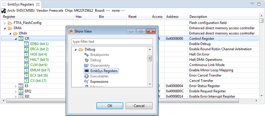

  • Added CMSIS-SVD Peripheral Register viewer.

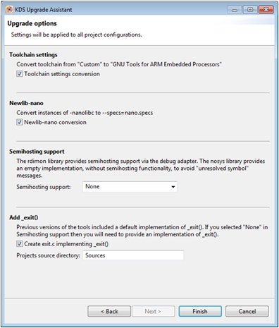

  • New upgrade/migration assistant to migrate projects to V3.0.0.

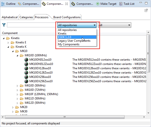

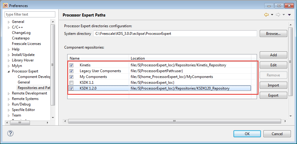

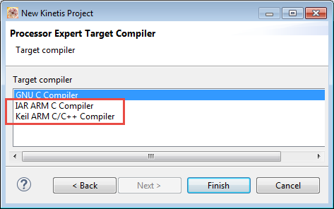

  • New Processor Expert V3.0 with multiple repository support and simplified Kinetis SDK usage and ability to generate projects for IAR and Keil.

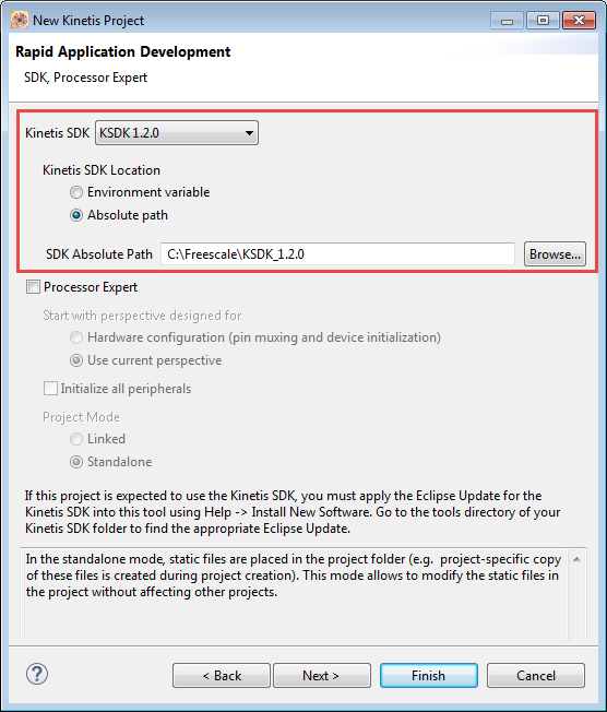

  1. Download the Kinetis SDK v1.2 from Software Development Kit for Kinetis MCUs|Freescale
  2. Install the Kinetis SDK
  3. Add Kinetis SDK v1.2 to KDS: Use the menu Help > Install New Software and use C:\Freescale\KSDK_1.2.0\tools\eclipse_update\KSDK_1.2.0_Eclipse_Update (KSDK path on windows)

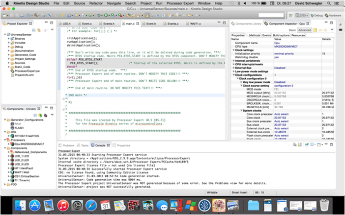

Mac OS X support:

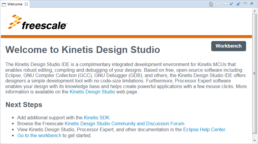

New Workspace Welcome view:
Kinetis SDK selection in New Project Wizard:
Ability to generate Processor Expert (Microcontroller Driver Suite) external projects for IAR and Keil:

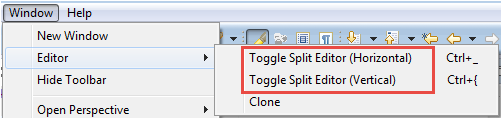

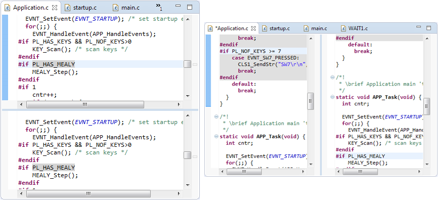

Eclipse Luna 4.4, e.g. Split Editor Views:
Processor Expert V3.0 and multiple component repositories:
Upgrade assistant to migrate projects from KDS V1.x/V2.0.0 to V3.0.0:

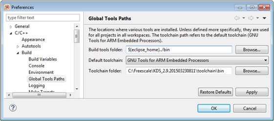

Multiple tool chain configurations:

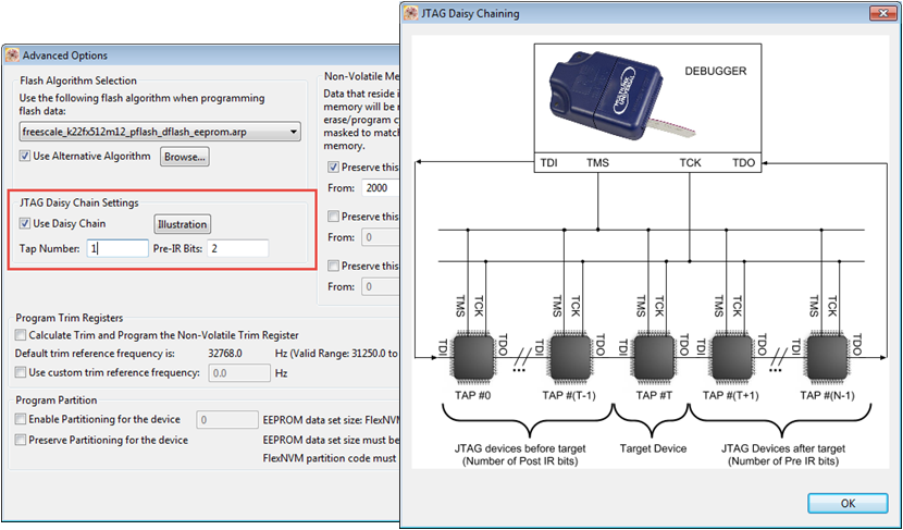

JTAG Daisy Chaining:

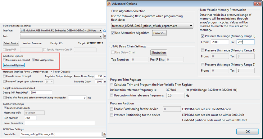

Advanced Flash Programming Options:

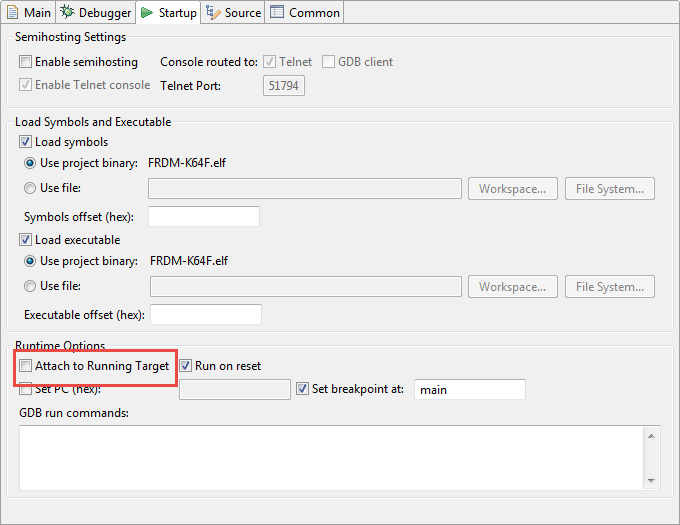

Attach to running target:

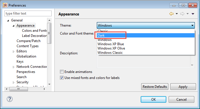

And finally, for the 'lovers of the dark side' :-): Eclipse Luna 'Dark' style:

The new KDS seems great so far! In the release notes for accessing the Register View, I think they meant to say:
"Window > Show View > Other > Debug" instead of Help > Show Views ...
-Angus

Hi Angus,
thanks for reporting this. This already has been fixed in the Rev1 version of the release notes (attached to this page). The installation comes with Rev0 which indeed has that error in it.
Erich
