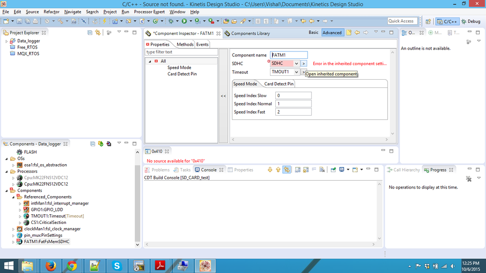

   I am using FRDM-K22F. It has MK22FN512VLH12 MCU. I am following the below link to set up SD card and use this to log data to the SD card.
http://mcuoneclipse.com/2012/07/30/fatfs-with-kinetis/
Tutorial: Data Logger with the FRDM-K64F Board | MCU on Eclipse
When I add FatFsMemSDHC component, I get the error - Error in inherited component. I have screen shots below.
Can someone please help me. Also can some one point me to the free tutorial to use Processor Expert. Looks like it is pretty cool. I am not used to it and I am new. If i get free tutorial, that will be great. Please help me.

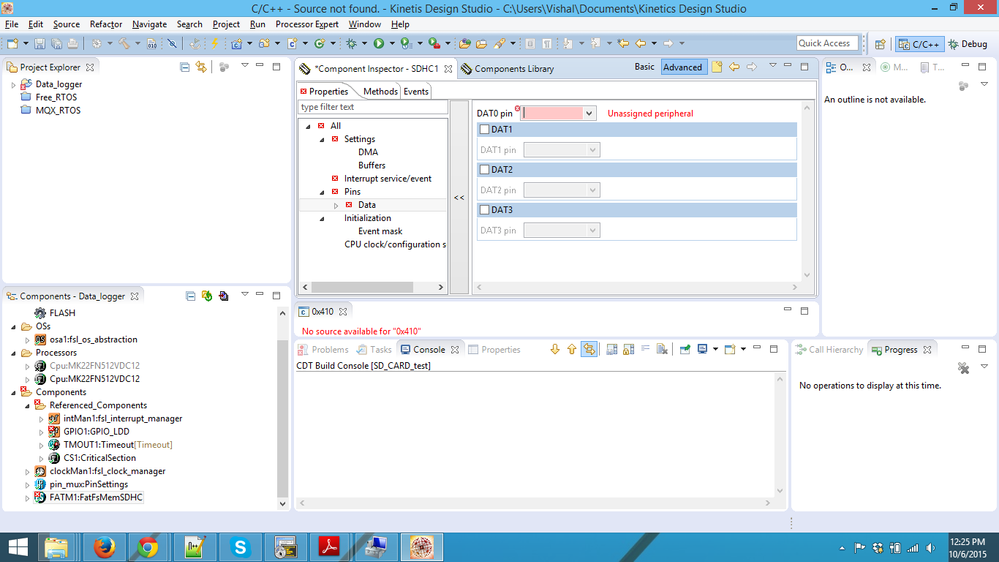

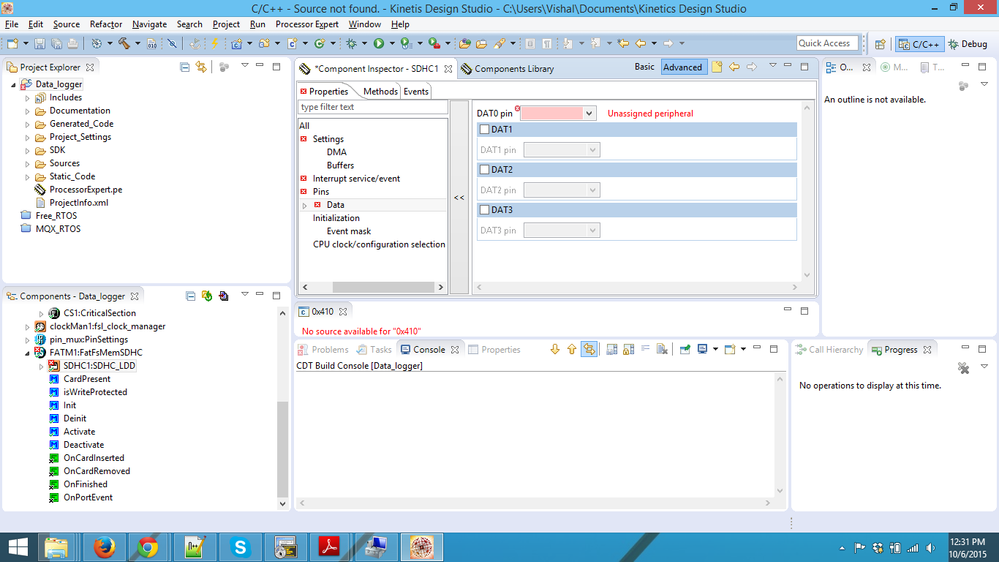

  Also SDHC_LDD shows error. I think the main reason for error is SDHC_LDD.

The problem I see from the screenshots is that the Kinetis SDK is used. The thing is that the Kinetis SDK does not come with Processor Expert components compatible with the SDHC Processor Expert components, so it produces that error.
Instead, create a project *without* the Kinetis SDK enabled.
