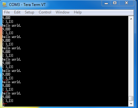

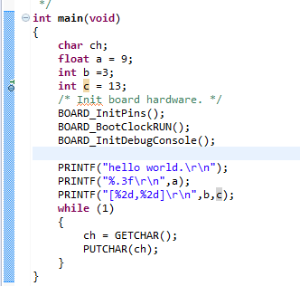

Hello Stephen,
When use this form,  %2d,if the data i  = 3;  it can print one black space and  3.
Like this :
My Code is like this , i use KDS v3.2 , KSDK v2.0 .
Does this can meet your demand ?
Hope it helps
Alice
