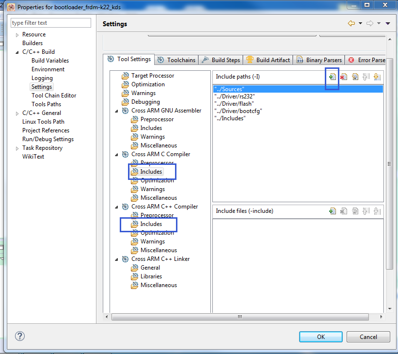

I am using KDS 3.2 and the KSDK 1.3. I have some problem to include some header files in .h that I create, but I can include them in the .c files. Why this happens and how can I solve it?

Hello Pedro,
Have you add the paths for header files in the Properties :
If still can't work , please provide more information about your question.
Hope it helps
