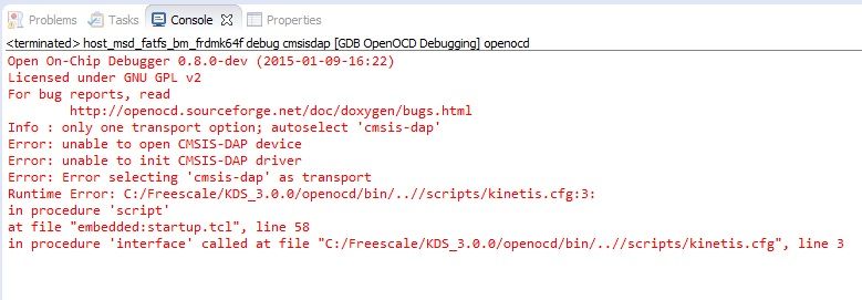

I am trying to run a demo app that is located in the following folder:
Freescale/KSDK_1.3.0/examples/frdmk64f/demo_apps/usb/host/msd/msd_fatfs/bm/kds
I am not sure if you can run a demo app or if its just use for reference?
I have the FRDM-K64F board and I am using the SDAUSB port to load it.  I am not sure if this is
correct? Is that the right port? What should I use to debug it (host_msd_fatfs_bm_frdmk64f debug csmisdap)?
I am getting the following error I am attaching.

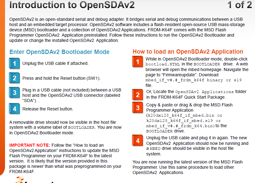

I followed the instructions for using the OpenSDAv2. I first placed the FRDM-K64F board on bootloader mode, then found the
k20dx128_k64f_if_mbed on the following website: Firmware FRDM K64F - Handbook | Mbed  and loaded on the board.  I finally
loaded or try to load the demo app msd_host_fatfs_bm_frdmk64f and first tried the debug, then the release version and both
gave me an error.
Here is the console error:
Here is a picture of the new EMBED host file after following the steps of the OpenSDAv2
Let me know if any of these help you understand what is happening?

Hello Neil,
Please load the "Jlink_OpenSDA_V2"file  I attached last time to bootloader ,
then use "GDB SEGGER J-Link debugging" when download APP  .
Also don't cut " J5, J8, and J12" .
Alice

I was able to figure out the problem.  Once I loaded the binary file to the OPENSDAv2, instead of using my
P&E multilink to run the demo, I created a binary file which I dropped inside the MBED file that comes up.
This way I was able to run the demo.
