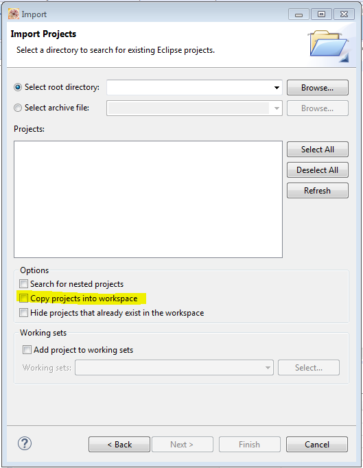

I have installed KDS 3.2 and the KSDK 1.3 mainline. I have also installed the package inside KDS in order to use it. At this point it was all fine. However, when I import an example from the KSDK_1.3file tree and try to compile it, an error occurs:
make: *** No rule to make target 'C:/Freescale/KSDK_1.3.0/examples/frdmkv31f/driver_examples/i2c/i2c_blocking/master/kds/../../../../../../../lib/ksdk_platform_lib/kds/KV31F51212/debug/libksdk_platform.a', needed by 'i2c_blocking_master_example_frdmkv31f.elf'.
make: Target 'all' not remade because of errors.
Could someone help me solve this issue?

Hello Pedro,
Does this problem been fixed?
If not, please first build the platform library for KSDK.
About the detail steps for  how to build a KSDK demo application, please refer to
Getting Started with Kinetis SDK (KSDK) v.1.3.pdf ->  5 Run a demo using Kinetis Design Studio IDE

Hi Pedro,
during import of the example ensure, you will uncheck "Copy projects into workspace" (see attached picture). The examples link some files and if you copy the sources, links do not work.
Marek
