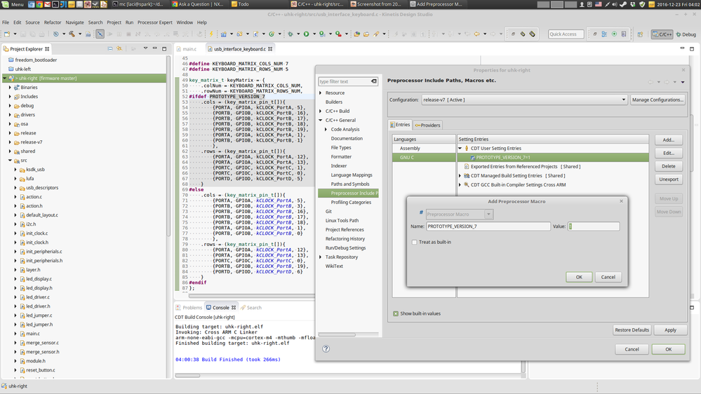

Hi there,
I'd like to use the preprocessor include macros feature of KDS to be able to build different firmware images on a per build profile basis for the various versions of our prototypes. Please see the following screenshot:
For some reason this doesn't work because:
  1. The exact same firmware image gets built as without the macro.
  2. In source code code editor the PROTOTYPE_VERSION_7 macro section gets grayed out instead of the else clause.
I'd be really grateful if someone could help me.
Thanks in advance!
- Laci

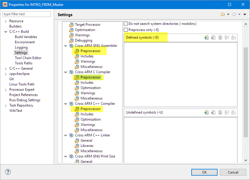

Hi Laci,
add your preprocessor symbols under the -D compiler (C, C++, assembler):
The other thing to know is: Eclipse uses the Indexer data base to gray out the sources. Depending on your project, I recommend you disable heuristics and rebuild the index, see Fixing the Eclipse Index | MCU on Eclipse
I hope this helps,
Erich

Thank you so much for your help! Erich's instructions totally solved my problem.
Now I have only one question left: What is the preprocessor include macros feature of KDS supposed to do? It seems to me that it doesn't work.
