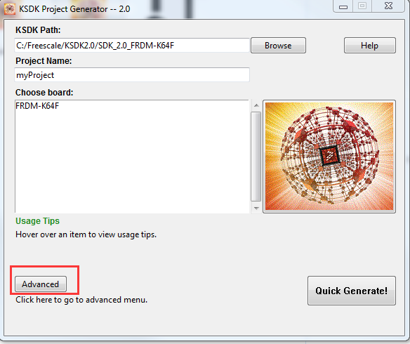

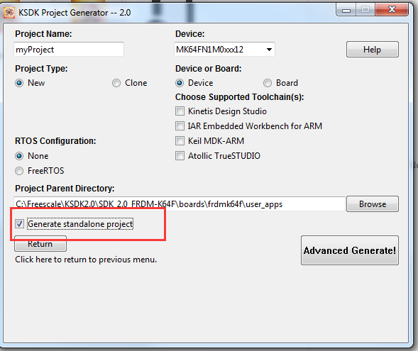

Hello Christie,
Yes, it can . Please enable "Generate standalone project" as below when use KSDK Project Generateor:

MarekTrmac
Hi Christie,
If you want ot create new project with all source files copied into the project, then select option New.
If you want to clone existing example with all source files copied into the project, the select option Clone.
In both cases ensure check box "Generate standalone project" is turned ON.
