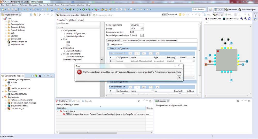

Hi.
Finally i got KDS installed and updated to newest version 3.1.0, PEx 3.0.2b, KSDS 1.3.0.
I'm trying to start new simple project with PEx for processor: mkl03z8vfg4
Every time I add one of those components:
Component: i2cCom1 of type fsl_i2c<br/>Description: Kinetis SDK
Peripheral Driver (i2c)
Repository: KSDK 1.3.0
Component: spiCom1 of type fsl_spi<br/>Description: Kinetis SDK
Peripheral Driver (spi)
Component: adConv1 of type fsl_adc16<br/>Description: Kinetis SDK
Peripheral Driver (adc16)
Component: voltageRef1 of type fsl_vref<br/>Description: Kinetis SDK
Peripheral Driver (vref)
and press the Generate PEx code button (Cant remember the right name) I get a following ERROR:
ERROR: Not possible to run: Drivers\Kinetis\printConfigs.js.javax.script.ScriptException:
sun.org.mozilla.javascript.internal.EcmaError: TypeError: Cannot find
function getEditorData in object
com.processorexpert.core.service.api.internal.PExInspectorIntegerItemAPI@404e93.
(<Unknown source>#89) in <Unknown source> at line number 89
Components are configured,  and I can not see any errors.
Other components added (and dependent of those) are working fine.
What i'm doing wrong ?

marcinmazur
So, there is my project.
It is ... empty. Just Clock, and I2c.
4,337 Views

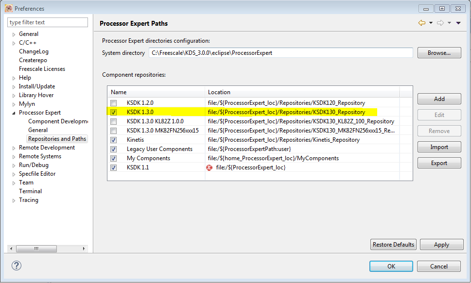

MarekTrmac
Hi, I've tried your project "test_1" in KDS 3 and I can generate the code without any error.
Can you go to Window - Preferences - Processor Expert - Repositories and Paths and checkl if KSDK1.3 repository is listed and enabled?
Attached is a screenshot, what I have installed on my computer I've highlighted row that should be mandatory for your project.
Regards, Marek

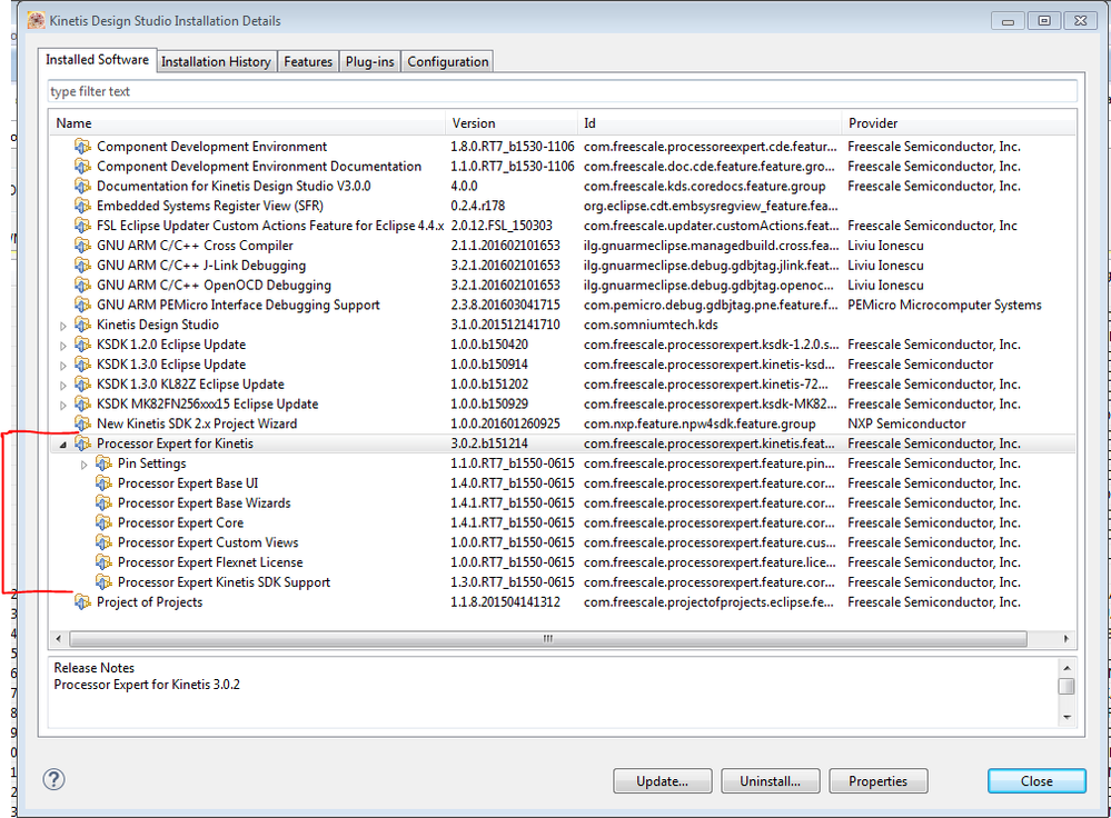

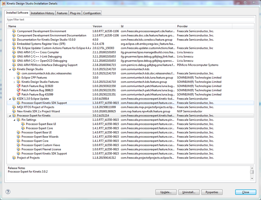

4,337 Views
MarekTrmac
what operating system do you use?
I've created the project based on your description and I do not see any problem with code generation.
Can you double check, if you have the Processor Expert 3.0.2 fully installed, using Help - About - Installation details (see attached picture).
Marek

marcinmazur
Hi.
I'am using Windows 7 Pro, 64bit.
Today I reindtalled whole KDS + KSDK ... and the problem still exists (new project)
My installed components seems to be pretty same as Yours:Capture.PNG
Any idea ?
