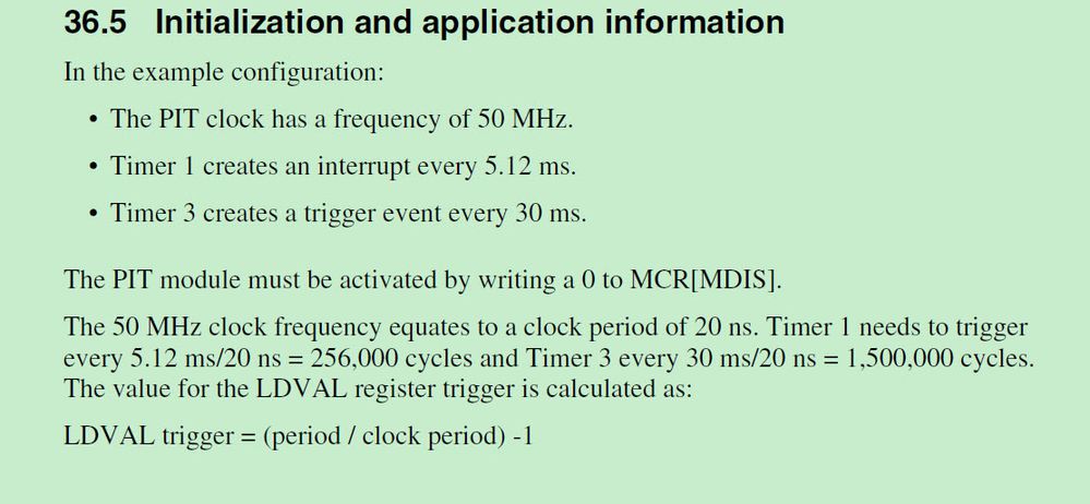

  1. About the PIT time value definition.
  You can find it from the K02 reference manual, PIT chapter:, there has an example:
If you want to get 240ms, you should check your bus clock at first, because the PIT clock source is bus clock.
  Then,  calculate the LDVAL register value:
    LDVAL register = (period / bus clock period) -1
  If your bus clock is 50Mhz, then LDVAL register = 12000000-1.
The above is the PIT principle, but if you use the KSDK, you should configure it like this:
DELAY_TIME= 240000;
pit_user_config_t chn1Confg = {
                                .isInterruptEnabled = true,
                                .periodUs = DELAY_TIME
240ms=240000us.
