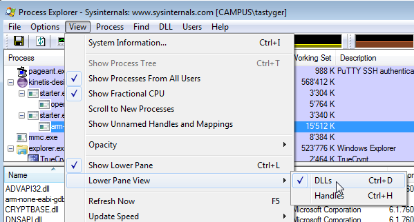

4. Enable DLLs for the lower pane view:

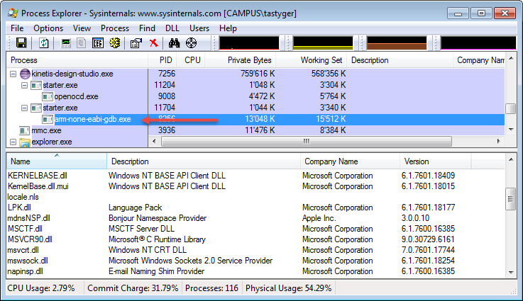

5. Locate and select arm-none-eabi-gdb.exe:

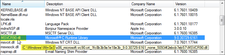

6. In the lower pane you should have several MSVCR*.dll you need to check
7. The MSVCR90.dll should be loaded from WinSxS
The other I have is from syswow64:
What I think is that one of these DLL's on your system are loaded from somewhere else?
Especially check for the one which is not loaded from WinSxS, and make a note of that path.
