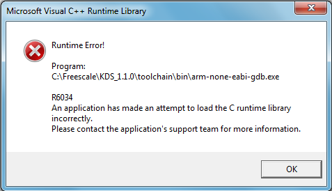

When i debug with KDS, i always have the following issue, but still can debug normally.
And the arm-none-eabi-gdb.exe can be found in the path: C:\Freescale\KDS_1.1.0\toolchain\bin.

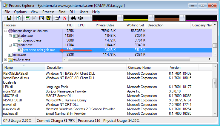

1. If you do not already have this, download and install the Process Explorer (Process Explorer) from the Windows Sysinternals
2. Start a debug session with KDS so that arm-none-eabi-gdb.exe to reproduce that that "Runtime Error! R6084" dialog.

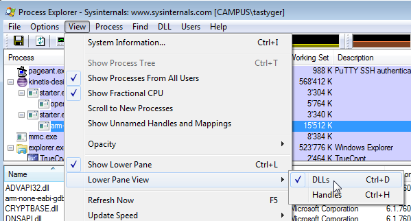

3. Start the Process Explorer.
4. Enable DLLs for the lower pane view:
5. Locate and select arm-none-eabi-gdb.exe:
6. In the lower pane you should have several MSVCR*.dll you need to check

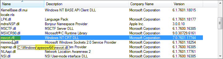

7. The MSVCR90.dll should be loaded from WinSxS
The other I have is from syswow64:
What I think is that one of these DLL's on your system are loaded from somewhere else?
Especially check for the one which is not loaded from WinSxS, and make a note of that path.

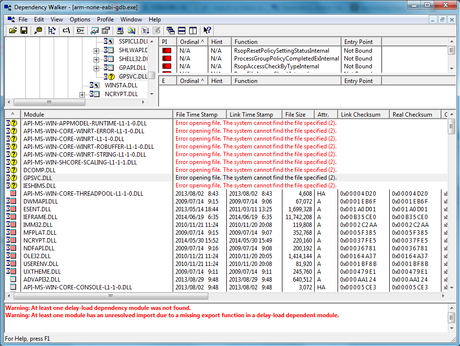

that might be a problem like this one: http://stackoverflow.com/questions/24988815/import-wx-failed-under-gdb-python-interface-r6034-an-app...
So it seems it cannot load/find a DLL/library correctly.
Can you try the dependency walker (Dependency Walker (depends.exe) Home Page) utility and check what DLL's are missing/not found?
It should produce an output something like this for C:\Freescale\KDS_1.1.0\toolchain\bin\arem-none-eabi-gdb.exe:
Erich

Hello Erich, Thanks for your quick respose every time!
I open the arem-none-eabi-gdb.exe in Dependency Walker, it shows as below. Is it means cannot load/find DLL/library correctly?
For example GPSVC.dll, it shows error opening file and cannot find it, but i can saw GPSVC.dll in the path: C:\Windows\System32.
