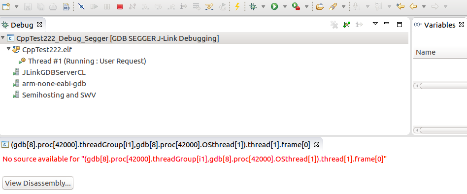

bluetiger9
Hi Marek,
Thanks for your suggestion. I tried it and the following happens:
  • the project is successfully created along with a main.cpp
  • the build is successful, with some warnings:
    DescriptionResourcePathLocationType
    redeclaration of memory region `m_text'CppTest222line 61, external location: /opt/Freescale/KDS_v3/toolchain/arm-none-eabi/bin/ld:../MK82FN256xxx15_ram.ldC/C++ Problem
    redeclaration of memory region `m_interrupts'CppTest222line 59, external location: /opt/Freescale/KDS_v3/toolchain/arm-none-eabi/bin/ld:../MK82FN256xxx15_ram.ldC/C++ Problem
    redeclaration of memory region `m_data'CppTest222line 60, external location: /opt/Freescale/KDS_v3/toolchain/arm-none-eabi/bin/ld:../MK82FN256xxx15_ram.ldC/C++ Problem
  • but when I try to upload & debug the project, I get this:
     and the board is still executing the old program.
I looked into the logs, but I can't figure out what could be wrong.
Here are the consoles from KDS:
CDT-Global-Build-Console - Pastebin.com
gdb-traces - Pastebin.com
JLinkGDBServerCL - Pastebin.com
arm-none-eabi-gdb - Pastebin.com
Can you please take a look?
Attila
