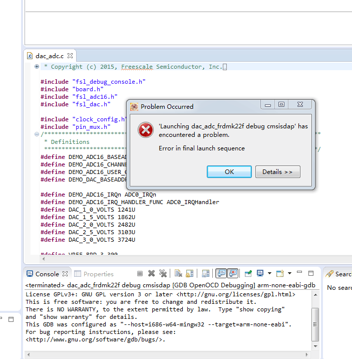

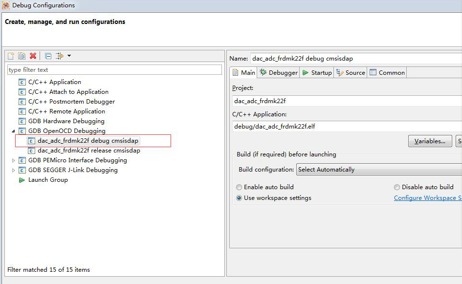

Hello there, there comes a problem when i follow the getting start, also shows my debug configurations154502_154502.png2.png

to identify if the problem is in specific project or a common issue for all project/workspace, please create a new project with wizard in a NEW workspace, see how it works.
if still can not connect, please follow this document to check your FRDM-K22F board connection.
https://community.nxp.com/docs/DOC-330146
Can this help you?
