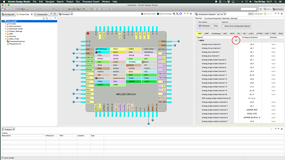

I've just started to transition to KDS from Codewarrior (my development cycles are intermittent). I have successfully installed and run KDS and created a new Kinetis project based around the FRDM-KL26Z. In Processor Expert view, when I uncheck "init" for any of the subsystems (for example ADC) the program hangs, giving me the spinning beachball of death.

stefandzisiewsk
Hi Pascal
Yes, this is the same issue. Carlos, I have attached an image of where the error occurs with the checkbox that causes the hang circled in red.
Hope this helps
S

4,111 Views
stefandzisiewsk
Hi Carlos
OS X version is Yosemite 10.10.5. All other aspects of KDS work, it's just I can't use Processor Expert because of this - but I am actually getting good results without, so it's not a huge issue for me, but might be for others.
S
4,111 Views
Carlos_Mendoza
Hi Stefan,
Thanks for your response.
Could you post an screenshot of the init setting you change on the component before KDS hangs?
Best Regards!
Carlos Mendoza
Technical Support Engineer
