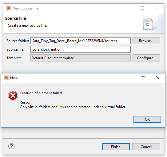

sarastout-grand
Hi Neil,
Thanks for the info. I tried what you suggested, but I get the following error. What does this mean?
That "sources" directory is sort of virtual since I don't see it anywhere in my folder explorer window. The main.ca file sits outside of a bunch of other directories that look nothing like what KDS shows.

marek-trmac
Hi Sara,
Eclipse contains its own file system. It means files in the Eclipse Project Explorer does not need to be in the same directories as they are displayed. "virtual folder" means, it is not a real folder on the disk, the folder represents only "named location" that contains links to project source files.
Generally I'd recommend to avoid "virtual folders" in your project due to following reasons:
  • you can easily review the project content on the disk and in the Project Explorer, both contains the same files
  • you can easily backup or share your project (or put to Git), because all source files are in the project folder
Marek

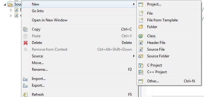

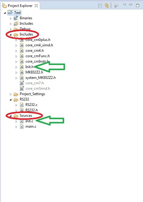

neilporven
Senior Contributor I
Sara,
I like to separate my specific functions in there own folders. It keeps things neat!
Your project folder contains a source folder and a Includes folder.
Source folder contains the .c files
Includes folder contains the .h files
like so,
You can create your function such as Init.c by right clicking  on the Source folder and selecting New->source file and
the same would hold true for Includes-> Header File,  but right click on the Includes file.
like so,
Neil
