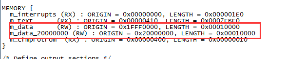

Hello Utsavi Bharuchwala,
1. "Total RAM available is 128KB in module. "
While the SRAM is split into two equally-size logical arrays, SRAM_L and
SRAM_U, so on your chip each one is 64KB. Please check the default linker file "ProcessorExpert.ld",:
 the .data and .bss part all placed into m_data, not use m_data_20000000.
So "bss + data =   0x1dce8 + 0x390  =  123000 bytes used." 123000 > 64KB , overflow.
2. Please check the *.map file under your project->debug why the bss is so large.
About the bss in Eclipse please check this thread:
text, data and bss: Code and Data Size Explained | MCU on Eclipse
3.In  your project, please don't use printf() print to console view, it adds greatly to
the code size of application and stack.
4.You can relocate the large data into the second RAM " m_data_20000000"
refer to : Relocating Code and Data Using the KDS GCC Linker File for Kinetis
Hope it helps

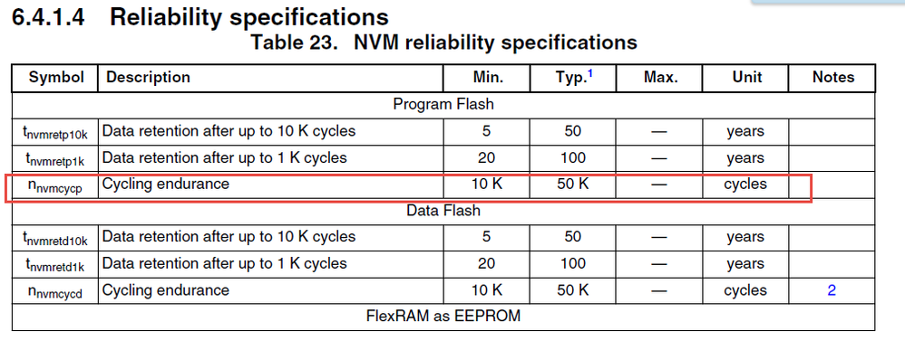

I have
const int_16 Buffer[8000]; //changing approx 15 times per month
This buffer store in Flash as a RAM, but i want to know  limit of  Flash write  cycle? What is a life of flash memory?
Can I use Flash as RAM in this case?
Utsavi Bharuchwala
5,946 Views
 Hello Utsavi,
1. In your linker file , the two RAM part SRAM_L and SRAM_U have merged  to one m_data (RW) .
2.About the method of store huge arrays into flash memory, please also refer to this DOC:
3.About the Flash life cycle , please check on the Data Sheet of your chip:
Hope it helps
TIC

One more thing there is no separate m_data_20000000 segment provided in my linker file. Segment in linker file is,
MEMORY {
m_interrupts (RX) :           ORIGIN = 0x00000000, LENGTH = 0x00000400
m_flash_config (RX) :       ORIGIN = 0x00000400, LENGTH = 0x00000010
m_interrupts_ram (RW) :  ORIGIN = 0x1FFF0000, LENGTH = 0x00000400
m_text (RX) :                    ORIGIN = 0x00000410, LENGTH = 0x0007FBF0
m_data (RW) :                  ORIGIN = 0x1FFF0400, LENGTH = 0x0001FC00  /*(130048 bytes)*/
How can I reduce bss size in KDS? How can I store huge arrays into flash memory if possible?
