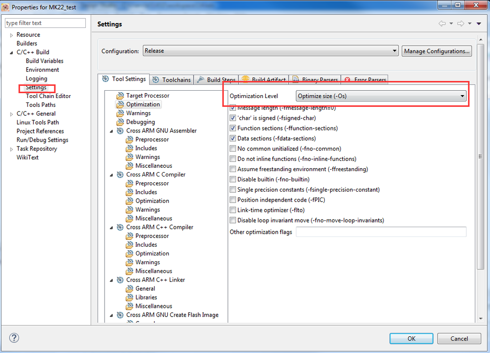

Hello Didier,
You can change the Optimization level at here :
Change it to "None(-O0)" .
Hope it helps
Alice

didierjeanjean
Thank you very much Alice,
You give me information to find where i can found optimization parameters.
But i need local solution to keep optimization for the other part of the code.
And i find a solution using pointer of pointer value that i named "ptptwrite"?
and even more volatile pragma is un-necessary.
