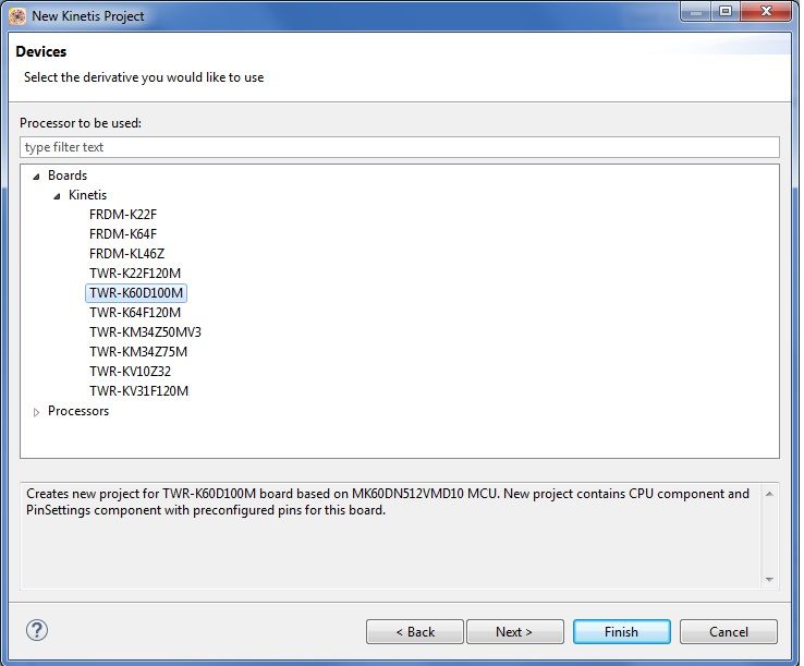

paoloziveri
Hi Jorge Alcala.
I want to create a new project.
But the board TWR-K60F120M is not present in the boards list (see the attached image)
Thanks for your support.

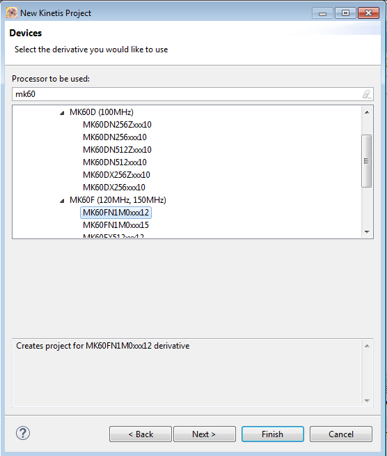

jorge_a_vazquez
Hi Paolo Ziveri
Sorry, I did not realize that you were using 120 MHz K60 MCU, in this case you have to choose the processor of TWR board, in this case MK60FN10xxx12:
This case occurs  because TWRK60F120M is not supported in SDK.
Hope this could help you, please tell us for any other problem
Jorge Alcala

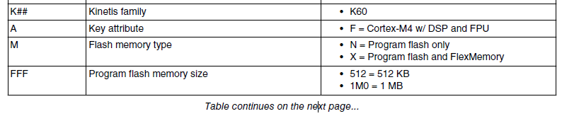

jorge_a_vazquez
HI Paolo Ziveri
TWR-K60F120M actually uses MK60FN1M0VLQ12, and since you have a MK60FX512VLQ12, both of them have same features, with the differences of 'N/X' and '1M0/512' witch mean:
In KDS (Kinetis Design Studio) you should have to select MK60FX512xxx12, not MK60FN1M0xxx12
Hope this helps.
Jorge Alcala
