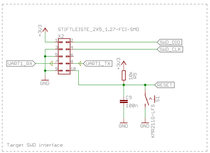

We are making the bare-board of KL03 boards as per reference design but we are not using OpenSDA section.
We are planning to debug the KL03 by SWD connector through PEmicro multilink universal Fx,  So what is recommended things for us to do for booting up that board ?

As Erich mentioned, you don't have to do anything special, if you plan to use an external debugger (like SWD connector through PEmicro multilink universal Fx), we recommend to check the KLQRUG (http://cache.freescale.com/files/32bit/doc/quick_ref_guide/KLQRUG.pdf), unit 2. General System setup, section 2.1.5.1 Debug interface. Here you will find hardware considerations for debug interface. As Erich mentioned, keep an eye on the reset line (pull-up, capacitor), and also the state of NMI pin.

Hello Idris,
You don't have to do anything special, but keep an eye on the reset line (pull-up, capacitor). Below is what we use for a K20 (tinyK20, see https://mcuoneclipse.com/2016/02/16/how-to-put-the-kinetis-k20-on-the-tinyk20-board-into-bootloader-... )
The UART1_RX and TX are non-standard (we use that for a UART-2-USB bridge).
And you can use the KL03 with Kinetis Design Studio and the Kinetis SDK. About Processor Expert keep mind that the SDK V2.0 does not support Processor Expert.

syed_idris
Ok, means when we power up the board then it will be in bootloader mode,
then directly can we use sample codes of KDS to debug the KL03?
Don't it need to flash a new firmware? If yes, how to flash a new firmware?
