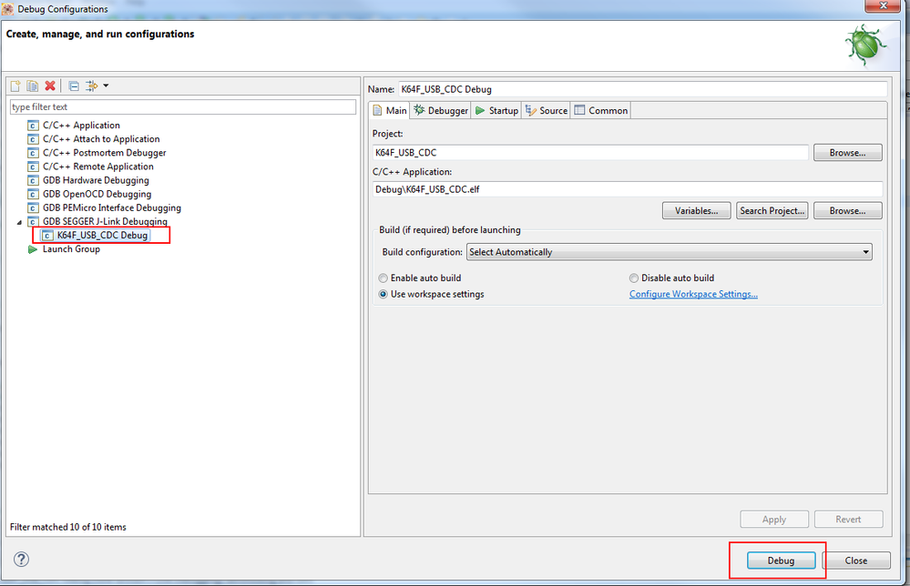

Hello Ernest,
I find the reason, please connect the 2-3 of J25 on the FRDM-K64 board,
then USB insert to J22, press the RESET button(sw1), then you can see the LED on/off .
For at the time , it directly reset the MCU, or it need reset through OPENSDA.
I also attached my test project .
Hope it helps
Alice

Hello Ernest,
I have test your project on my side , it can work well.
You do not need care the release or debug , in KDS , after download the it through debug ,
it also flash the project to the board , so please download it to your board,
then you can close the KDS, also can re-insert the USB to OpenSDA, then press
the RESET button , you can see the the red led ON .
I attach the video on my side .
Hope it helps
Alice
