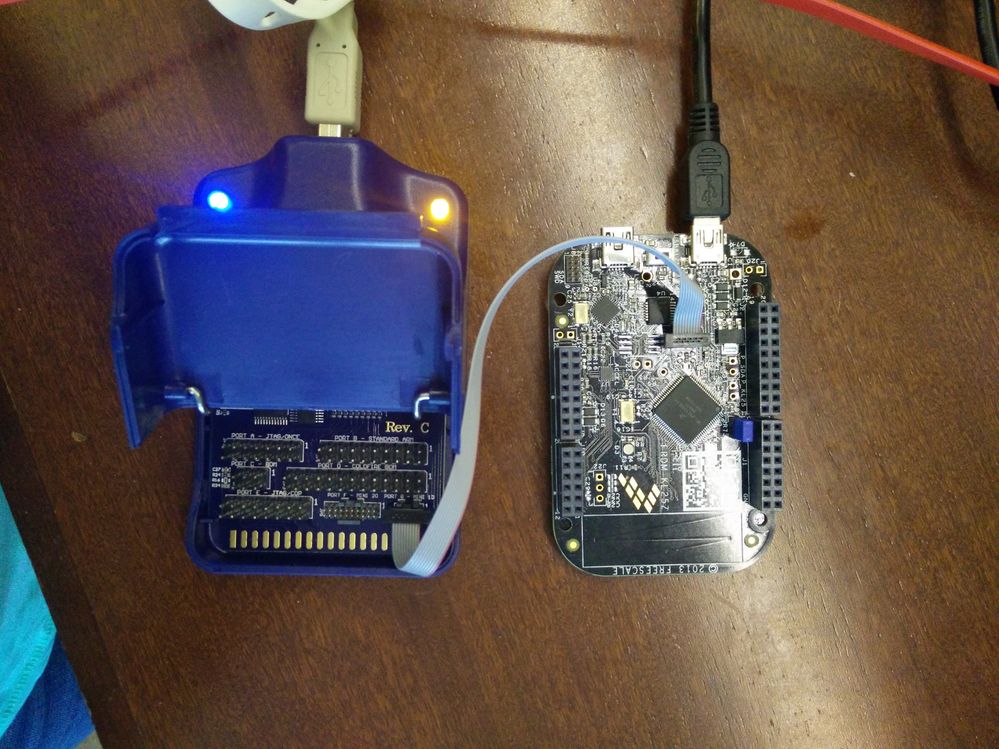

* I used this set up to connect the FRDM board to the Multilink:https://mcuoneclipse.com/2012/11/07/jtagswd-debugging-with-the-frdm-kl25z-board/
Here is a photo of my setup to confirm:

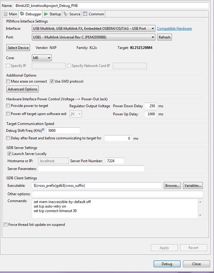

* This is my debug configuration. This is the same as I use to program with OpenSDA only with the Interface and Port options changed to the multilink.

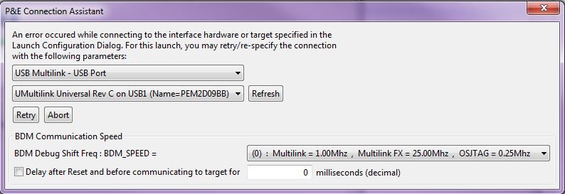

* When debug fails first I get this P&E connection assistant pop up:148326_148326.JPGfirst_message_when_debug_fails.JPG

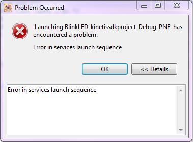

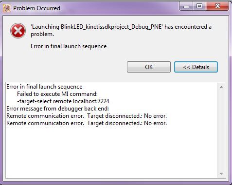

* The first time I tried programming after the new install I got this second error message after the P&E one:
* But now this one comes up after the P&E message:

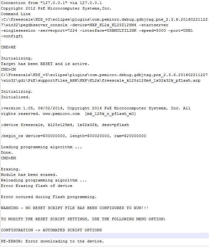

* One of the first times I tried to debug, it got as far as opening up the debug window and had this message in the console:
But I haven't gotten this message a second time.
