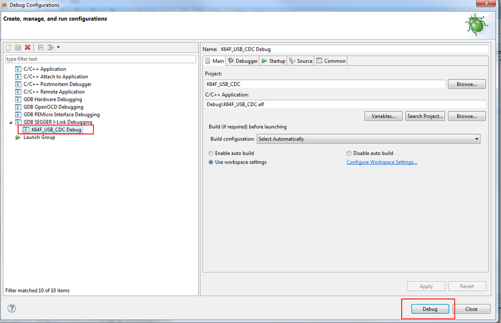

I just tried to run my code stand alone on the FRDMK64 but it does not run properly. I have noticed that the KSDK demos have two options for building under the hammer, debug and release however I currently only have a debug option in my project.
I can tell that in stand alone mode my "seconds" interrupt from the RTC is not occurring, but I can see that the PIT interrupt is working.
Can anyone explain how to resolve this please.

Hello Ernest,
I have test your project on my side , it can work well.
You do not need care the release or debug , in KDS , after download the it through debug ,
it also flash the project to the board , so please download it to your board,
then you can close the KDS, also can re-insert the USB to OpenSDA, then press
the RESET button , you can see the the red led ON .
I attach the video on my side .
Hope it helps
Alice
