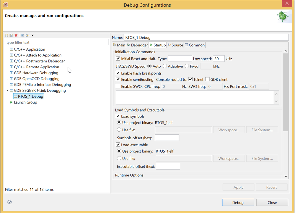

An internal error occurred during: "Launching MBED_A5".
ilg.gnuarmeclipse.debug.gdbjtag.dsf.GnuArmServicesFactory.<init>
(Ljava/lang/String;Ljava/lang/String;)V
http://mcuoneclipse.com/2014/04/27/segger-j-link-firmware-for-opensdav2/
Installed JLink_OpenSDA_V2_2015-10-13.bin by copy paste to H:\BOOTLOADER

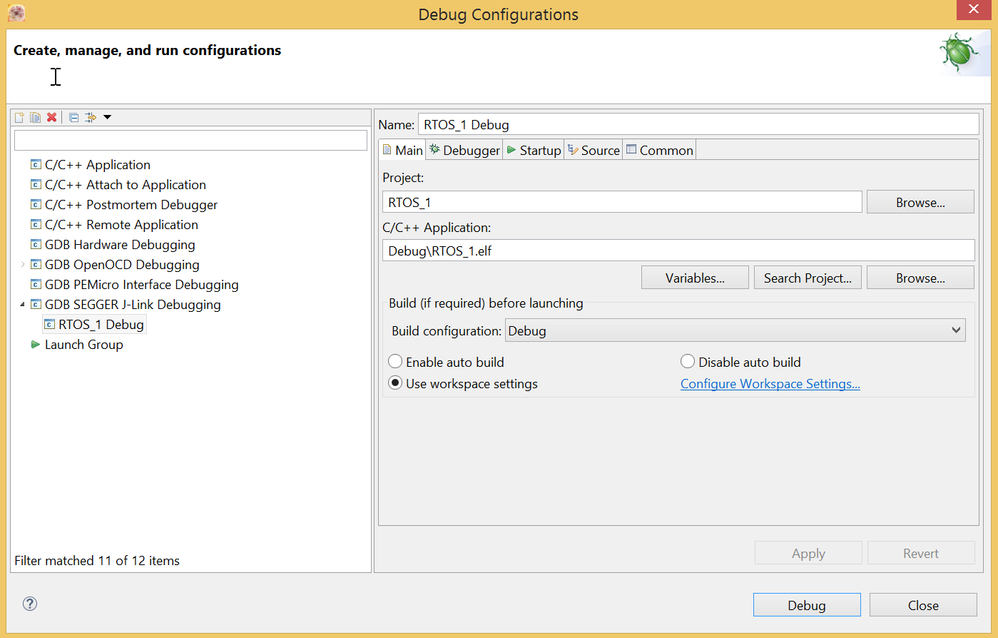

Tried to setup new Debug Configuration:
An error has occurred. See error log for more details.
ilg/gnuarmeclipse/debug/gdbjtag/data/CProjectAttributes
Solution: https://community.freescale.com/thread/363937
Installed two plugins (replacements of existing files)
This enabled the use of JLink_OpenSDA_V2_2015-10-13.bin with Test 4 being part of bsilvereagle's article: (only up to line 7 of main())

3,863件の閲覧回数
kg1
K64F locked up while debugging.
Always try this solution first especially if you are new to KDS and from mbed.org:
Error message from debugger back end:
localhost:3333: The system tried to join a drive to a directory on a joined drive.
(1) Download this file: https://developer.mbed.org/media/uploads/sam_grove/helloworld_k64f.bin
(2) Copy and paste the bin file into your MBED drive: the file loads into your K64F.
(3) Reset your K64F.
(4) This bin file runs ok! Recommence debugging your original program on KDS.

3,862件の閲覧回数
kg1
Hello Alice,
Yes it works with J-Link openSDA debug. OpenOCD did not work with this project or this one Getting Started with Kinetis SDK . Is it faulty?
Kevin.

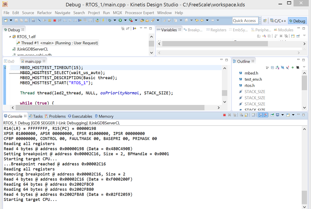

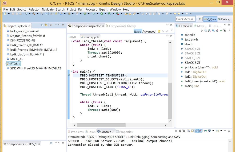

3,863件の閲覧回数
kg1
Hello Alice,
Yes I did get the three firmware packages mixed up. I can now step through this rtos program using OpenOCD:

3,863件の閲覧回数
kg1
Hello Alice,
Thank you for your reply. In the bsilvereagle's article I am up to here:
"Run code on K64F
Note: I use the Segger J-Link OpenSDA application for debugging. The K64F by default uses OpenOCD. I believe just pressing the 'Debug' icon while the K64F is plugged in should debug the application. I recommend using the Segger J-Link debugging interface. A post will follow on how to do this."
I tried OpenOCD which failed. Hence "I believe just pressing the 'Debug' icon while the K64F is plugged in should debug the application." is not true. Next I installed  Segger J-Link OpenSDA which does debug a simple test program but the program fails the test.

Next I completed the debug configurations:
Here are the main screens of KDS:
This time I immediately clicked Resume at the break point and it worked!
