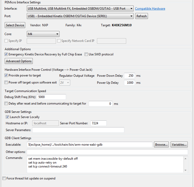

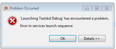

I tried to get the TWR-K40X256 going with the Kinetis Design Studio.
First I needed to make an Bootloader Update. Everything went fine. After that the Debugger was found.
After that I tried to flash with the following configuration159973_159973.PNGflashconfig.PNG
This failed with the an error.
Can anybody help me with this? I tried an Software Update. But it didn't work and I have no idea what is the problem.

Hello Erich,
Thanks to you, I could solve this problem. There was another gdb in my PATH variable. Everything worked.

Hi Erich,
I think the direction is right. I looked but the gdb is not running, and it is not started anyway.
So I searched for ist. But in the path "C:\Freescale\KDS_v3\Toolchain\arm-none-eabi\bin" there is no arm-none-eabi-gdb.exe like your link has discribed.

Hi Dorothee,
the arm-none-eabi-gdb.exe should be in <kds>\Toolchain\bin
If it is not there, it might have been removed by a firewall or virus scan software?

BlackNight
Hi Dorothee,
maybe gdb is already running? see https://mcuoneclipse.com/2015/05/18/gdb-client-and-server-unlocking-gdb/
I hope this helps,
