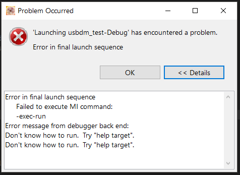

I'm currently trying to use USBDM to program my board. I'm usign Kinetis Design Studio 3.2.
I followed the instructions posted here to install CDT plugin so everything is installed.
When I try to debug the application, I get an error.
I tried reinstalling everything three times but no luck.
Any help would be appreciated.

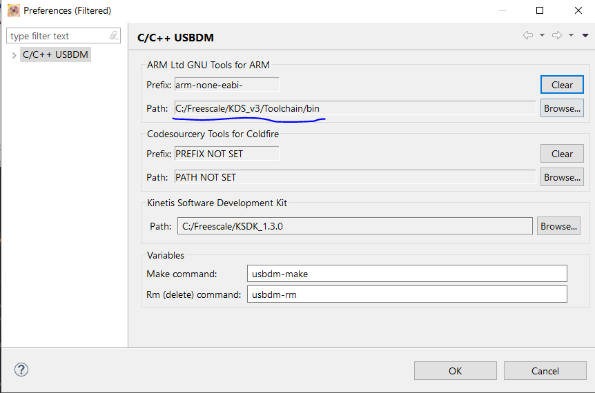

I've been trying to solve this for two days and now i find the problem one hour after I post here.
The problem was the path to the ARM Ltd GNU tool.
The picture above has the correct path. Before, I had this path "C:\Program Files (x86)\GNU Tools ARM Embedded\5.4 2016q2\bin"
