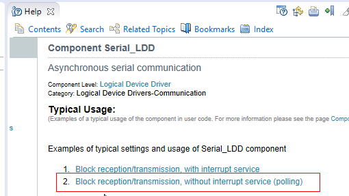

There's no DMA description on KEA128 RM, is this mean no DMA support on KEA128?
If it support DMA, do anybody give an UART DMA transmit/receive sample? I want to implement a receive with an idle interrupt, transmit with any length.
4,426 Views
Hi xiaofeng,
Do you meaning do not use interrrupt . Yes, you can also use polling mode ,
check the TX/RX flag status . There is also the polling demo under Typical Usage:
Hope it helps

Hello ,
Yes, it doesn't support DMA .

Hi Yang, I think it's not practical which PE does is that OnBlockReceived event require we have to know that the number to be receive. And the polling method may lost frame if receiving loop slow.
What I need is that:
1, if block sending finished, there's interrupt to notify me, then I can set transmit finish flag(or call it transmit idle).
2, when receiving, I want to avoid RX interrupt on each receive byte in interrupt mode which is low efficient, OR receiving byte maybe lost in polling mode.
Thanks!
