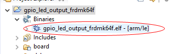

Hi Rudy,
Your original file is .bin file ? KDS can't flash .bin file .
The kds also can produce the hex elf file by itself :
Alice

rvigneault
Hi Alice,
The original file seems to be a .elf file. In "Flash from file...", when I select "Search Project...", I see .elf files (one for debug and one for release).
Using the debug one works and the release one does nothing.
I am still investigating this on my side but I even think that the .bin I was talking about previously is generated from the .elf!! Maybe there is a modification needed (done by our setup) on the .bin before it can be used to flash.
I will let you know although it might take some time since for now I have a workaround.
Rudy
