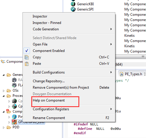

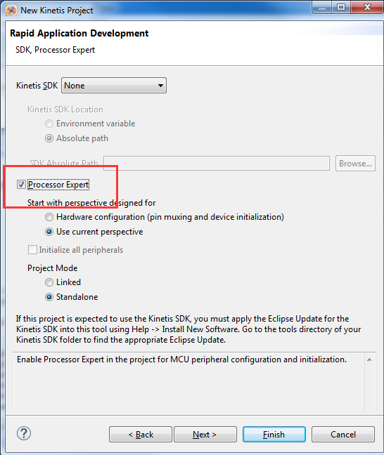

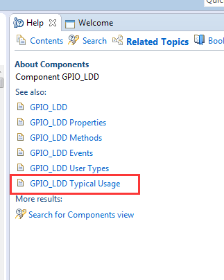

- You can also create a project on kds with Processor Expert, then there is demo when add related component :
For example add "Gpio" componnet :
