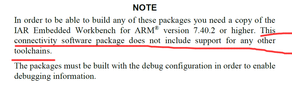

Hello Carlos
It seems the "Kinetis KW40Z Connectivity Software" only support the
IAR toolchains .
