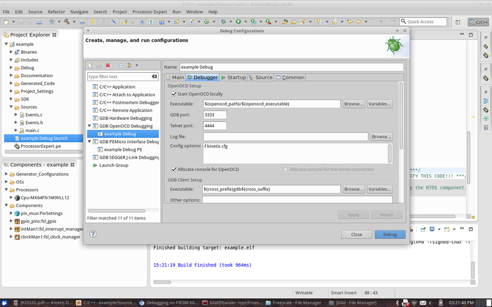

bilalarain
I have the same problem, may be you guys can help. I have followed the user guide (KDSUG.pdf) and configure the debugger as shown in the image:

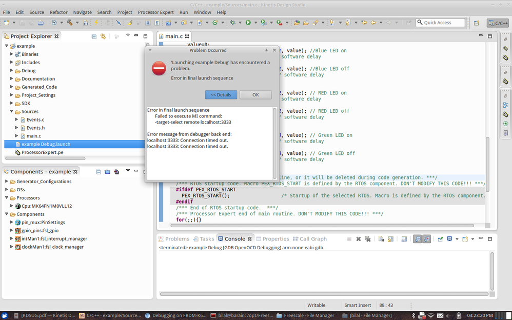

When debug, I got the following error:
Note that I am using Ubuntu 14.04 and I am using the preinstalled bootloader. The Debug port is /dev/ttyACM0. I have been searching on the web but could not find any solution to solve this problem. Will look forward for your help in this regard.

BlackNight
Hi Bilal,
do you have the latest firmware loaded on the board? See http://developer.mbed.org/handbook/Firmware-FRDM-K64F
But in any case I don't recommend to use the mbed firmware: the Segger and P&E one are much more stable and easier to use.
And 20 times faster!
See http://mcuoneclipse.com/2014/04/27/segger-j-link-firmware-for-opensdav2/

bilalarain
Hi Erich
It works out nicely. Many thanks for your help.
Bilal
