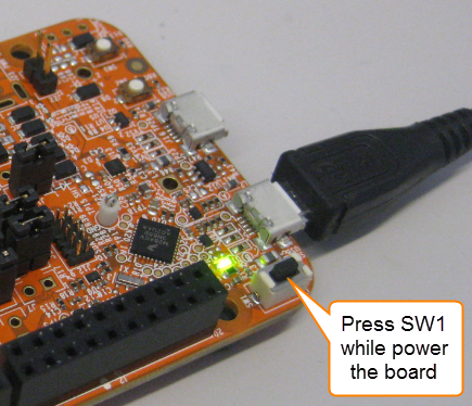

  3. Power the board/Plug in the USB cable with the OpenSDA USB port, while having the Reset/SW1 pressed.
  4. The device should enumerate BOOTLOADER: device on your host. You are now in bootloader mode.
  5. Copy the Segger .bin file to that BOOTLOADER device. Wait a few seconds to complete the operation.
  6. Unplug the board, and now power it normally (without SW1 pressed)

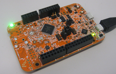

  7. The board should now show up as J-Link device and with a virtual COM port:
  8. You are ready to use to debug the FRDM-K22F as if you would do with a Segger J-Link :-)

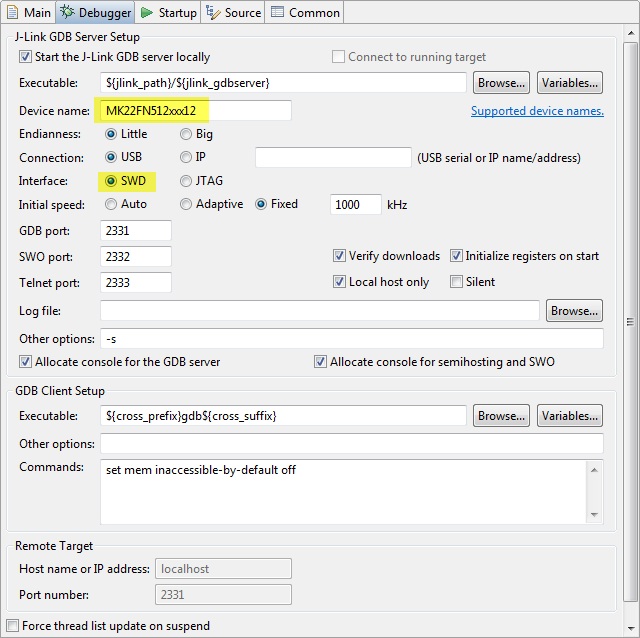

Create a new debug/launch configuration: Select your project, then use the menu Run > Debug Configurations.
Use the 'new' Icon to create a new configuration for your application and project (Main tab):
Specify MK22FN512xxx12 as your device name, and make sure 'SWD' is selected:

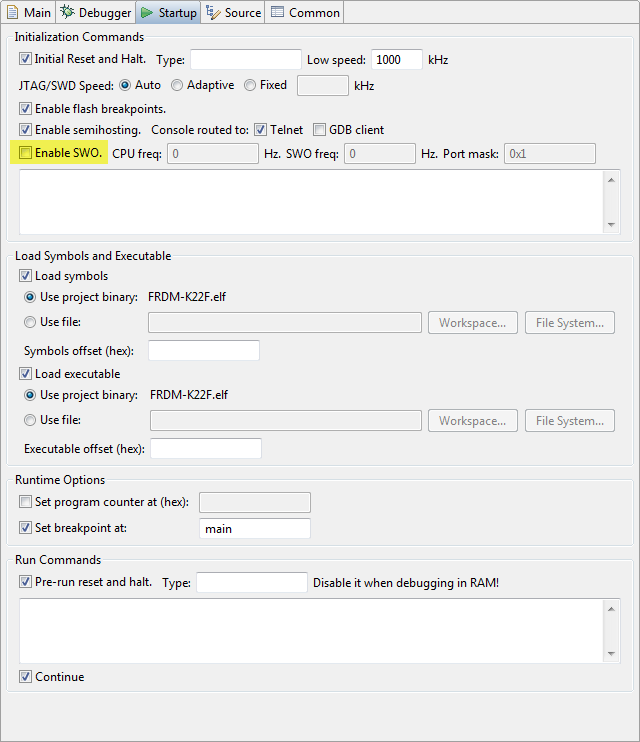

Have SWO disabled:

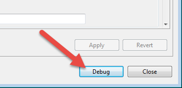

That's it. Now you can debug your application with Segger J-Link OpenSDA V2.1 firmware on the board :-).
You can use the 'Debug' button in the launch configuration:
Or use the debug icon drop-down list:
