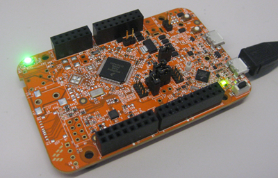

  7. The board should now show up as J-Link device and with a virtual COM port:
  8. You are ready to use to debug the FRDM-K22F as if you would do with a Segger J-Link :-)

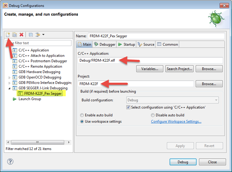

Create a new debug/launch configuration: Select your project, then use the menu Run > Debug Configurations.
Use the 'new' Icon to create a new configuration for your application and project (Main tab):

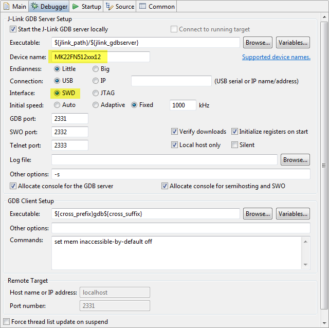

Specify MK22FN512xxx12 as your device name, and make sure 'SWD' is selected:

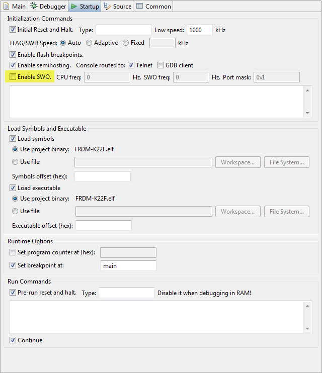

Have SWO disabled:

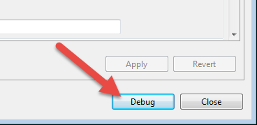

You can use the 'Debug' button in the launch configuration:
Or use the debug icon drop-down list:
