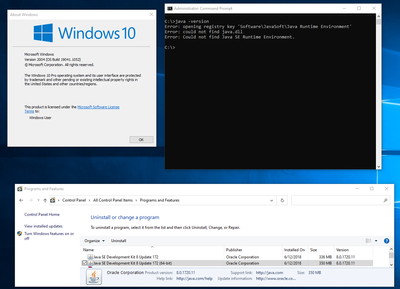

i am getting the following error when trying to generatecode, run simulator,or run target
Error: opening registry key 'Software\Avast\Java Runtime Environment' Error: could not find java.ll Error: Could not find Java SE Runtime Environment.

Not real sure how to check on my java installation, but I did some peeking around and found that some install must have installed the Java SE development Kit 8? (see attached pics below)
I never purposefully installed it and don't know how to use it. I'm running Windows 10 (see pics below for current version).. And interestingly enough if I type in the command "java -version" and  I get the same error.(See Pics)
I'm lost for a solution at this point? Do I uninstall and reinstall a new version of the JAVA SE? does an environment variable need to set to point the the installation? do you know of hand what quiGuider supports?

LiubinGong
from your pics, I guess that your host pc missed JRE(Java Runtime Environment), only installed JDK(Java Development Kit).
You can uninstall this JDK, and reinstall the full Java environment. The appropriate version can be obtained from GUI Guider doc.

skruglewicz
Thank you LiubinGong
That was exactly it. The JRE was missing and I only had the JDK installed. I should have read the GuiGuider User Guide... I am no longer getting the following error:
What I did was
1) uninstall the 2 versions of the JDK as I wanted a fresh install.
2) downloaded a new JRE from Oracle from this page Java SE Runtime Environment 8 - Downloads - Oracle
I download the follow version.
Windows x64
80.7 MB
jre-8u291-windows-x64.exe
And installed it. The install only installs the JRE because I don't need the JDK at the moment.
3) I then added path "C:\Program Files\Java\jre1.8.0_291\bin" to the PATH System environment Variable.
4) to test the installation from a command I ran the following java command , and it displayed the current version.
