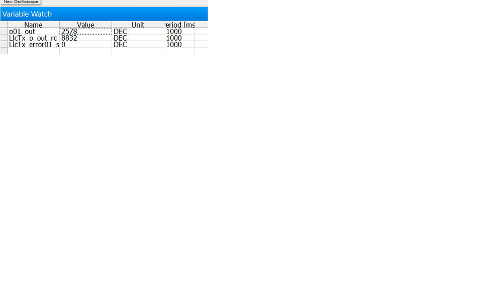

can freemaster add a feature that user can process the sample data in watch table?
for example ,i want to process the p01_out data in the form of p01_out/19200*300
can we add some basic math to help user process the sample data,thx u!

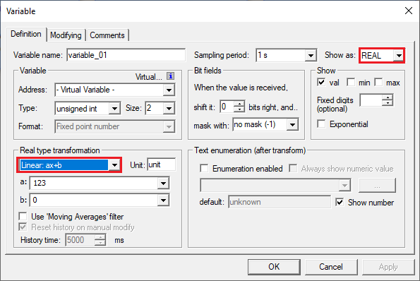

Hi @tiasum,
FreeMASTER supports "Real type transformation". You need to set "Show as" property on your variable to "REAL" to enable it. For more information on this functionality you can refer to Ch. 4.2 Variables (Real type transformation) of the User Manual.
Hope it helps,
Iulian
