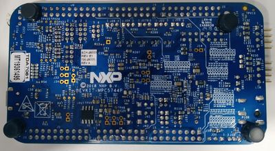

I need some help with connecting DEVKIT-MPC5744P to Freemaster tool via on board OpenSDA interface.
DEVKIT-MPC5744P - https://www.nxp.com/design/development-boards/automotive-development-platforms/mpc57xx-mcu-platforms...
I'm using DEVKIT-MPC5744P with S32 Design Studio for my projects and I want to use Freemaster tool for real time debugging. I couldn't find any example project for this board that utilize freemaster. As per to my knowledge, connecting the board to freemaster via on board OpenSDA interface should be done using UART module on the MC.
I could not find any example or documentation on how to configure UART module in order to connect to freemaster
Could someone please provide any example or documentation on this matter.

Just to be on the safe side, could you tell me what board revision are you working with.
Iulian
16,989 Views
Gayan_Niroshana
Hello @iulian_stan ,
Board revision - SCH 29333 REV E1 - 700 29333 Rev A
Does the example work on boards and freemaster detects the board ?
Thanks & Regards,
Gayan.
