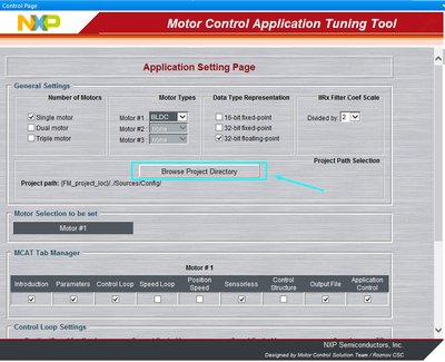

I met a problem about Freemaster project 'S32K_BLDC_Sensorless'. It can not generate configuration file correctly . When I click the button, it will not generate configuration file. Please help me.

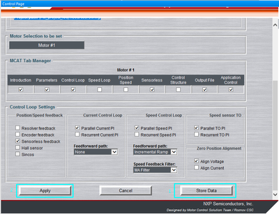

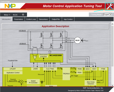

1) Open original pmp file outside Design Studio
2) Go to top right hand side corner. Configuration icon will appear as shown below
3) Click on it.  Application Setting Page will appear on the screen
4) Click on "Browse Project Directory"
5)   Click "Yes" to allow ActiveX control and navigate to project destination in Design Studio workspace
C: \ ...\ MCSPTE1AK144_BLDC_6Step \ Sources \ Config \
6) Once done, click Select. Project path should be like this
Project path: {FM_project_loc}../Sources/Config/
7) Click Store Data and Apply
File generation should work properly.
Marek

do you get any error when pressing the "Generate.." button? Is the content of the target file unchanged or does it get corrupted?
Michal
5,984 Views
XPQ
Dear sir
yes,the file will not change
