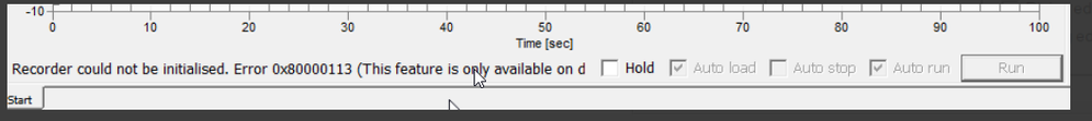

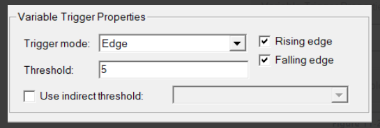

Dear Freemaster-Team,
We made some screenshots, which should hopefully explain the issues.
Where do I see, which variables have been chosen for trigger?
Both edges seem not be possible.
Error message can not be read.
Thanks for your help,
Martin Rieser

Dear Martin, plese re-post your pictures. It seems they are just links to your intranet site and I cannot display them.
General answer: recorder trigger settings can be set for each variable in the "Variables" tab. When selecting a variable in the list, edit the "Variable Trigger Properties".
In order to be able to activate both-edges triggering or the have more than one triggering variable, the target MCU application needs to run the latest FreeMASTER driver and must support protocol version 4. This driver is available as part of MCUXpresso SDK and some other NXP SDKs.
I will take a closer look at your issue after I see your screenshots.
Michal

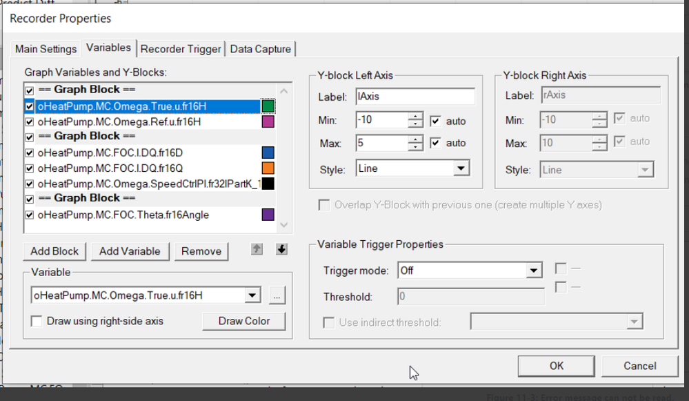

martinrieser
Hello Michal,
hopefully this time, the screenshots are working.
(You need to click throw all Graph Variables to find our, which one(s) are configured as trigger)
Martin

Dear Martin,
yes unfortunately, you need to click through all graph variables to see which one is set for triggering. We realize it is not convenient and will address this in future update.
The error message 0x80000113 tells you that the FreeMASTER driver running in the MCU application does not support the protocol V4 which only supports dual-edge trigger and/or triggering by multiple variables.
What is your target MCU and what kind of communication do you use? I hope I will be able to assist you in migration to a newer communication driver.
Michal

martinrieser
Hello Michal,
we are aware about the error because of the old protocol. In newer project, we use V4.
But the issue with the error message is, that we can only see a part of it. The error message is longer then the label/text field on the GUI. I think that should be a easy fix.
Martin
