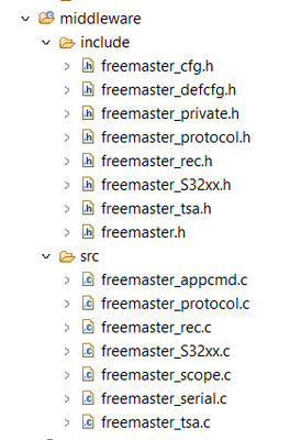

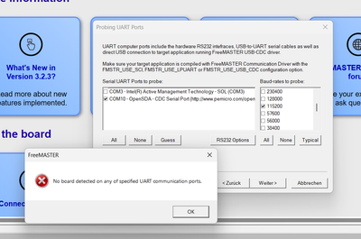

I have a project in S32 Design Studio 3.6.4 for S32 Platform with RTD and wan't to debug it with Freemaster 3.2. I use the S32K144EVB. Connection should be via LPUART 1 with PIN PTC6 and PTC7. I have included the freemaster drivers manually as you can see in the picture and changed LPUART 0 to LPUART 1 in freemaster_cfg.h
But Freemaster don't detect the Board...what can be the reason?

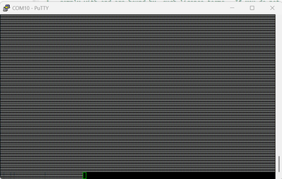

It seems that the LPUART is not properly configured or you use a custom baudrate - I can see only unprintable symbols in your putty terminal. Also, are you invoking the peripheral initialization routine - Lpuart_Uart_Ip_Init()?
Please note that FreeMASTER Driver does not configure the LPUART, you need to initialize it using RDT API before FMSTR_Init().

Could you confirm that you:
- included "freemaster.h" into your main source file
- initialized the FreeMASTER Driver using "
FMSTR_Init()"
- periodically invoke "
FMSTR_Poll()" routine.
If you are useing an interrupt mode:
#define FMSTR_LONG_INTR   1
or
#define FMSTR_SHORT_INTR  1
the interrupt is handled by "FMSTR_Isr()".
A quick check to confirm that the configuration is correct:
1. Switch to polling mode -
#define FMSTR_POLL_DRIVEN 1
2. Add the debug macro - #define
FMSTR_DEBUG_TX 1
3. Open a serial terminal (such as putty) and connect to the communication port.
In case of success you should see a continuous debug message sent from the board "+@W".
3,615件の閲覧回数
FBre99
Hi @iulian_stan ,
I added the debug macro and connected the communication port to Putty. The EVB sends the debug message. However, when I remove the debug macro and try to connect the EVB to Freemaster, Freemaster still cannot find the EVB.

FBre99
Hi @iulian_stan,
with the example project the connection with freemaster works.
Thank you.
