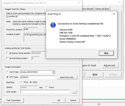

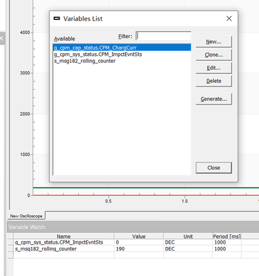

I'm using FreeMASTER to connect to a S32K311 board with Segger/JLink plug-in. However, when I start to communication (press Go button), my board stopped sending CAN messages, and the variable value in FreeMASTER I want to watch never changed. It seems the MCU stopped working.
My FreeMASTER configuration is as follow.
LuBiq_1-1765868500787.pngLuBiq_1-1765868500787.pngLuBiq_2-1765868515661.pngLuBiq_2-1765868515661.pngLuBiq_3-1765868535973.pngLuBiq_3-1765868535973.png
My FreeMASTER version is 3.2.6.3.
My JLink version is v8.94. And I also tried v 7.98.
My IDE, S32 Design Studio, version is V3.5.
I've tried the following solutions:
(1) Re-install FreeMASTER.
(2) Re-install JLink.
(3) Try other board with S32K342.
(4) Load JLinkARM.dll manually.
This question has been bothering me for many days. Can any body help me? Thanks a lot!

Hi @LuBiq,
Could you try the approach I described in this post ?

1,993件の閲覧回数
LuBiq
It works! Thank you so much!
