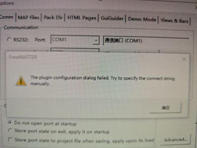

When configuring the can communication plugin, connection characters cannot be generated. Is there a new version of the can communication plugin for replacement?
15 回复数
2,494 次查看
MichalH
NXP Apps Support
NXP Apps Support
the error you show is a sign of wrong FreeMASTER installation. Please re-install the latest version (3.2.6) as administrator.  If you already have the latest version installed, you can fix the plug-in registration by running the "register.bat" as administrator. The register.bat is typically located in installation folder c:\NXP\FreeMASTER 3.2\FreeMASTER.
The version 3.2.6 brings updated CAN communication plug-in, which also supports CAN-FD mode for some host interfaces (IXXAT, Kvaser and ZLG).

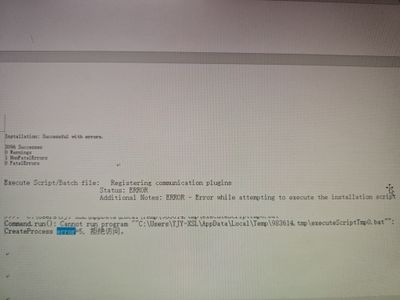

The installation log is displayed as follows
2,391 次查看
MichalH
NXP Apps Support
NXP Apps Support
The error=5 typically means "Access is denied" - for some reason your system does not allow plug-in registration. Do you run your installer "as administrator" ?

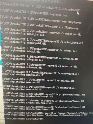

Please try the experiment I suggested above:
Start "cmd" command line prompt "as administrator", then 'cd' to "c:\NXP\FreeMASTER 3.2\FreeMASTER" and run register.bat.
Send a screenshot of the console output.

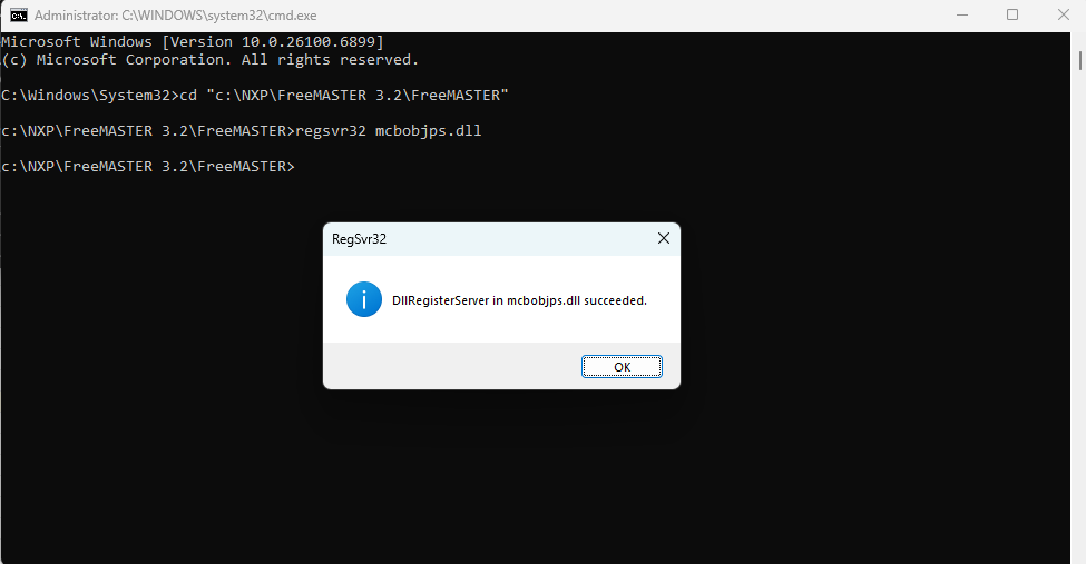

It should look similar to mine:
Michal
2,370 次查看
vcquwh
Yes, the same as yours
2,362 次查看
MichalH
NXP Apps Support
NXP Apps Support
It is not the same - notice the error messages in your output.
Please run this command in the same console:
       regsvr32 mcbobjps.dll
You shoud get a success message window. (but you will most likely get an error message):
Please share the output screenshot (You can use a pritnscreen key to get a screenshot to a clipboard and then Ctrl+V to message) .
