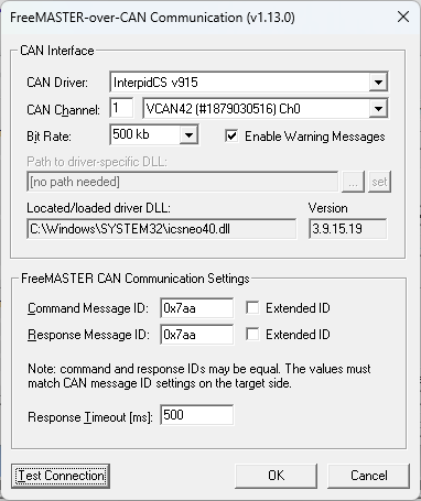

Can you give me your screenshot of the FreeMASTER plug-in configuration dialog when the "IntrepidCS" driver is selected? I'm interested in the version it prints. In my case, it is v901 (see picture below).
Also, can you display properties of the c:\Windows\SysWOW64\icsneo40.dll file and send me a screenshot of the Details tab? In my case, the DLL version is 3.9.1.31.
Also, please give me more information about the FreeMASTER crash. I don't know what is the flag_FMSTR that you reffer to - it is probably something specific to your target applicationI'm trying to understand if the crash occurs upon Initialization, Send or Receive action. Does the FreeMASTER crash immediatelly when you press the "Test Connection" button in the dialog? Can you try the following experiments?

My screenshots:
18,970件の閲覧回数
AG_92_Italy
Hi Michal,
As you requested, please find attached the screenshots you asked me. I already tried to send messages over CAN using another software (in particual I test it with Vehicle Spy) and the messages have been transmitted correctly.

P.S: FreeMASTER does not crash when Test Connection is pressed but in a second when I change the variable flag_FMSTR=1 (that is a switch - 0 or 1 - to enable or disable application messages). When I press Test Connection everything works correctly, and FreeMASTER recognizes the ValueCAN 4-2. I can also load a .elf file without problems.
